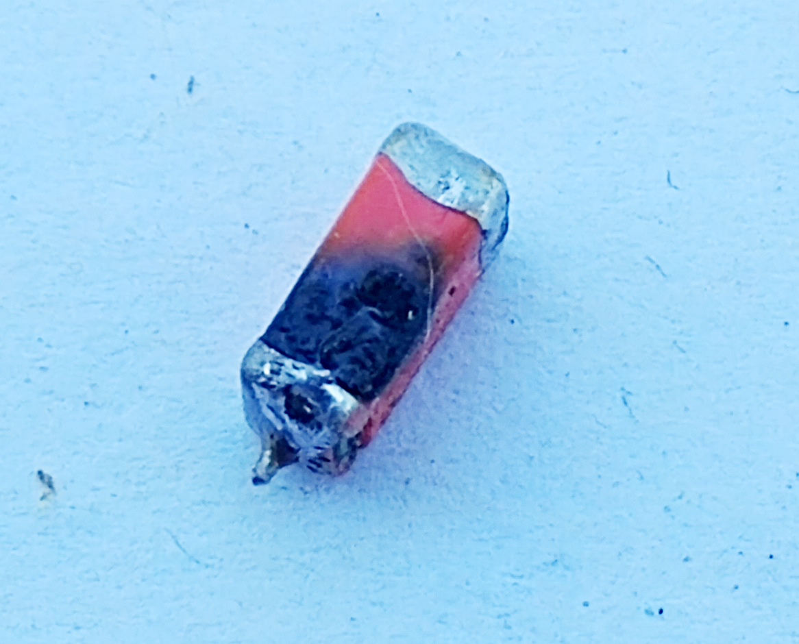

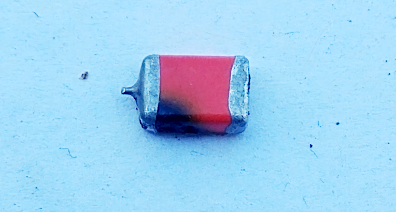

You answered my question about my inoperative GX65 a couple of weeks ago.  It came back from repair with the failed component (taped to the chassis) that looks like a small capacitor, not surface mount.  It has burn marks on the side, I can't imagine how I missed it when I looked over the boards with a 3X loupe.  If I sent it to you, (and where would I send it?) could you possibly identify how this could have failed?  I'm assuming that the radio now works, I have not installed it yet.

Got a chance to look over the fried capacitor you
sent. Yes, the darkened condition is strong evidence
of failure (shorted leading to overheating).
This style of tantalum chip capacitor is almost
vintage . . . very early package style that was
replaced with a more robust configuration. Yes,
it's a surface mounted part. That little pigtail
is not the remnant of a lead-wire.
I suspect that the replacement part was a
more modern design but yeah, this was quite
probably root cause of the radio failure.
