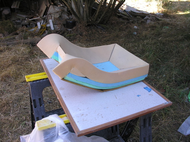

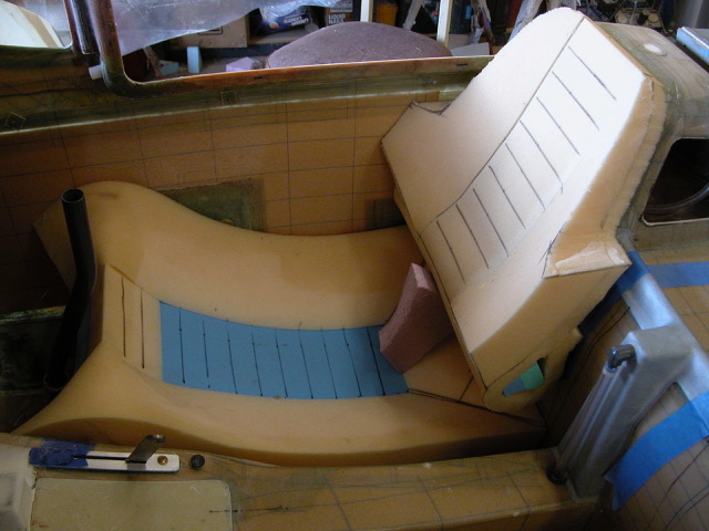

PostPosted: Thu Jul 01, 2021 9:45 pm    Post subject: Cushion for XS Reply with quote
Just to add one more bit…I’m 6’-1”, and my seat cushions are made up of 25mm green foam, 25mm blue foam, plus triangular wedges of furniture foam for thigh supports…I find the wedges to enhance comfort significantly,,,

One note of caution - Impact foam is quite heavy. I think it is a great safety feature and worth having in any aircraft. It probably let my friend get away with a non displaced vertebral fracture instead of a paralysis when he had a very heavy crash landing destroying the plane, but it doesn&rsquo;t need fully sculpted seats. A couple of layers of denser foam in the seat well could be covered with removable cushions made of lighter material and be more readily adjustable for differing pilots/passengers, saving quite a few pounds. Regards, David Joyce, GXSDJ
