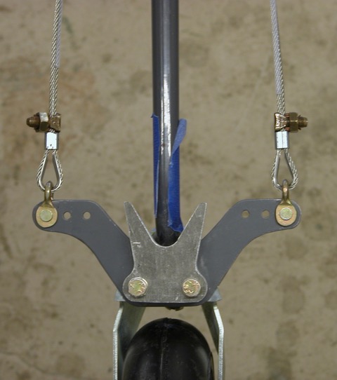

Phil…While I recognize you as a highly experienced Europa builder, I pass along two modifications to the stock Europa tailwheel which have been recommended to me by others.
First, add a stop to prevent the tailwheel from rotating more than approximately 30 deg in either direction...shown below is a half inch thick aluminum stop…mine came to me as part of the Singleton tail wheel mod.
Second, I cut off the ears of the stock fitting and made up a bracket from 1/8” 4130 plate configured to a design suggested to me by William Mills, RIP, which has two beneficial attributes: there are 3 sets of holes which allow for adjusting the sensitivity of rudder pedal inputs…(the outermost set of holes for the novice and allowing for less sensitivity, and by using the innermost sets of holes the result is less sensitivity and decreased turning radius)… and the sets of holes are further forward than the holes in the stock “ears” so that string lines dropping thru the holes are perfectly aligned with the vertical tail wheel pivot rod which decreases the strain on the entire assembly.
PS: Ignore the bronze split-bolts shown in lieu of the second set of nicopress sleeves.

David…you wrote:
"Sorry to disagree with Fred but I feel strongly you do not want to limit tailwheel travel to 30 degrees. I too have the Singleton mod and as you can see it allows the tail wheel to turn around 80 degrees in either direction.”
Of course I defer to your judgement and experience on all matters Europa…I believe I had written to limit tailwheel travel to 30 deg. in either direction, and I had just eyeballed the 30 deg. from my build photo…it may well be closer to 40 deg. in either direction which would yield the 80 deg. you mention which appears to be what your photo indicates.
As I recall, Graham’s instructions called for dressing the limiting block so that it mates with the tail spring when tailwheel rotates to its max. Some additional dressing of my install may be called for.
Thanks for your comment,
Fred
On Jun 8, 2021, at 8:25 AM, davidjoyce(at)doctors.org.uk (davidjoyce(at)doctors.org.uk) wrote:
Phil, Sorry to disagree with Fred but I feel strongly you do not want to limit tailwheel travel to 30 degrees. I too have the Singleton mod and as you can see it allows the tail wheel to turn around 80 degrees in either direction. This is a great help in manoeuvring either whilst taxying or pulling the plane around in the hangar. Experienced mono pilots can almost pivot on the main wheel with a judicious use of throttle and brake.(Emphasis on judicious - overdo it and you go A over T and break the prop). I have no figures for it but I would be very surprised if you need as much as 20 degree tail wheel turn in the process of landing or T/O, where the emphasis should be on sticking meticulously to a straight line, correcting any deviation sooner rather than later. I understand the function of the stop is to prevent the wheel twisting beyond 90 degrees when the rudder cables would be crossed and rudder action would make things worse rather than going back to neutral position.
Regards, David Joyce GXSDJ
