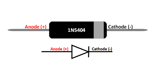

Pretty much any diode will do. If you get it backwards, the saving grace is the start solenoid is looking for 12 volts. Of course, the solenoid must be grounded.
Most mistakes are the ground is left off the solenoid when putting on the diode. Another problem is guys don’t insulate the anode side of the diode and it shorts.
The Rotax manual doesn't comment on the diode. But it is an accepted practice to extend the life of the contacts in the starter solenoid. The Europa Electrical Chapter 25 advises to use an IN5404 but any will do.
IN5404 <![endif]--><![if !vml]>[img]cid:image001.png(at)01D75B0E.9AC39E20[/img]<![endif]><![endif]--> silicone diode is shown above. Anode or plus side is on the starter switch tab and the cathode or negative goes to the ground bolt holding on the starter solenoid. I use at least a #18 or 16 wire from the solenoid fastening bolt to the main firewall ground.

Dave,
OOPS. Look at the diagram, I misspoke.  The cathode side on a solenoid spade contact and the anode or positive goes to the ground.
It’s getting late and the mind is a terrible thing.
Follow the pictures in the Bob Knuckles book or the Europa Electrical Diagram.

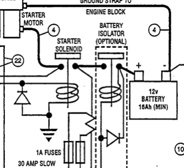

PostPosted: Mon Jun 07, 2021 1:56 am    Post subject: Starter Diode Reply with quote
[img]cid:070B7AAB-492A-4B44-8713-20F43830CB6D-L0-001[/img]
The diode is connected across the starter solenoid coil not the contacts for the starter motor as per the extract from the build manual above. There is no diode across the starter motor shown in the build manual diagram, at least not my version.
With 12v positive on the starter contacter coil the diode, with the cathode or marked end of the diode connected to positive terminal of the starter coil, is reverse biased and so will not conduct. When the starter button release the falling emf, magnetic field, produces an opposite voltage in the coil and can spark across the starter switch contacts eventually damaging the contacts, the diode shorts out this so the spark does not happen.
If the diode is shorted out, or the wrong way round, then solenoid will not work, assuming the solenoid will operate without diode connected as a test to ensure it’s the wiring of the diode that’s the problem of course.

Dave,
I didn't see anyone commented on your diode.
IN5404 <![endif]--><image001.png>
Best Regards,
Bud Yerly
Isn’t explaining electrical problems by email fun……….🤩
Alan
Sent from my iPad

Bud,Still confused as Europa Manual wiring diagram shows Anode to Earth? Not switch.
Best Regards,
Bud Yerly
