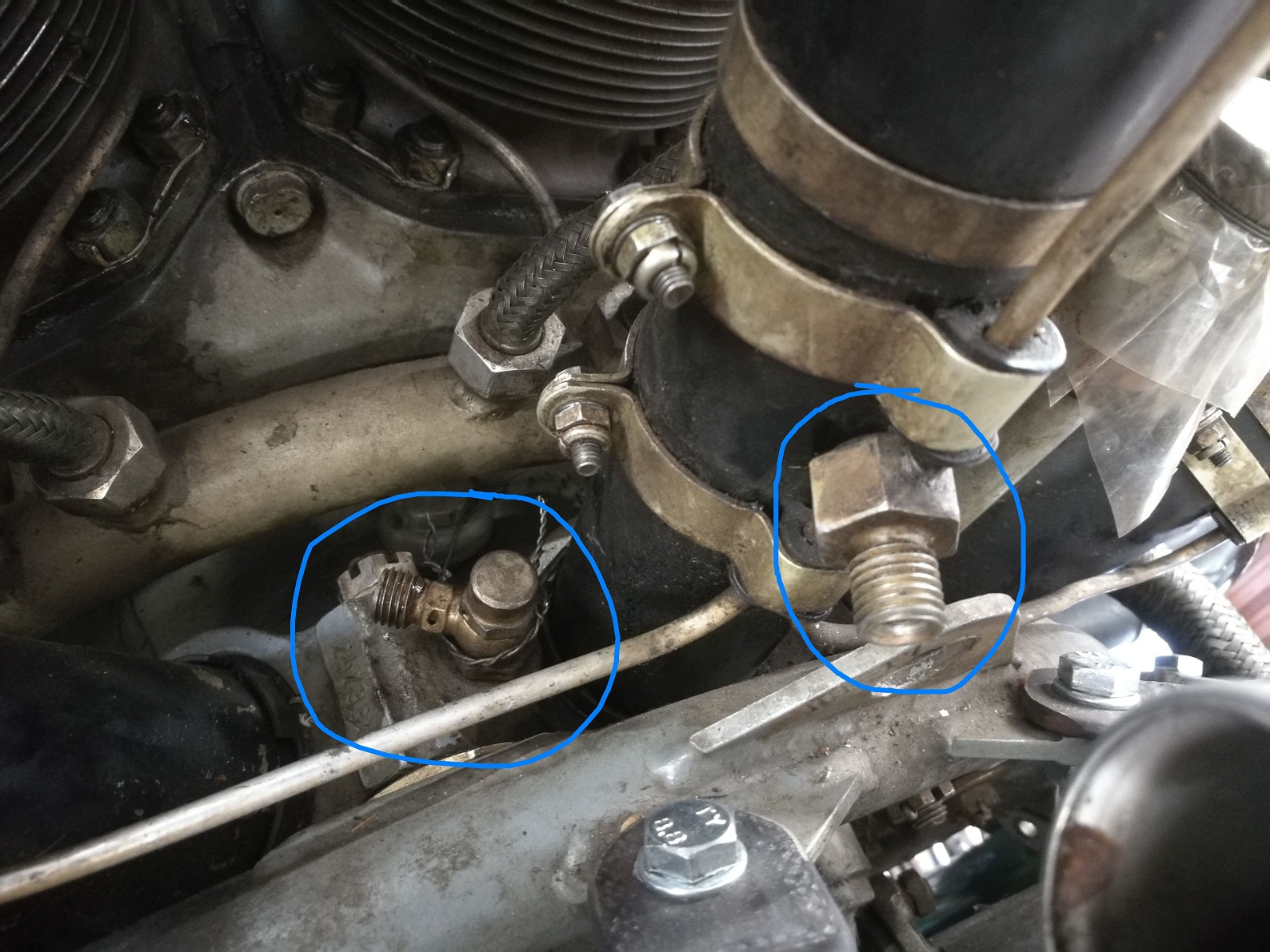

Hello all,
I'm still working on my M462 testbench and things are making progress so far. But there are two connections where I am not sure about their usage. Please find the attached picture.
- The right connection goes to the upper three Cylinders. My assumption is, that is used for priming the engine before start.
- The left connection looks like it's connected to the supercharger housing. So, perhaps there is a pressure gauge connected
Can someone confirm this?
many thanks
Robert

No problem. The left fitting takes the supercharger boost pressure and the fitting on the intake tube is for injecting fuel for starting. There are three intake tubes like this.
Richard

Thanks Richard!
