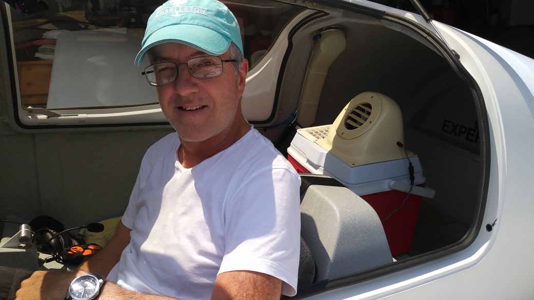

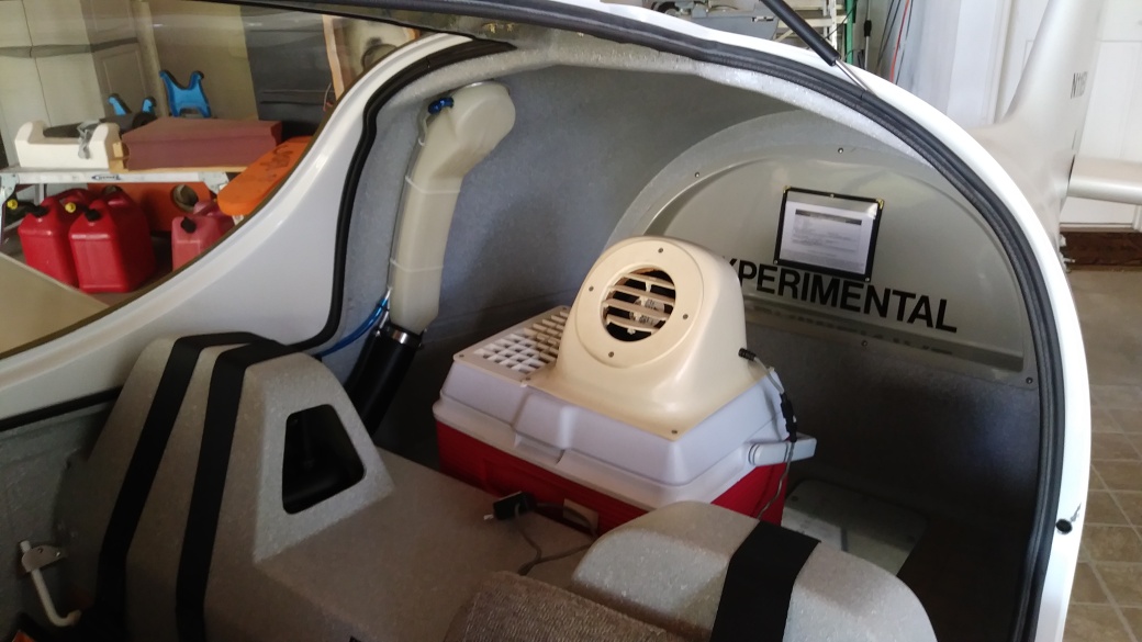

I mention the following just for the fun factor since I don't consider it very practical but I got a cheap used Arctic Cooler (picture attached) that haven't really tried yet in flight. It works but only if you can get ice that is Smile Not very practical but fun experiment.
Best Chris

wdaniell.longport(at)gmai
PostPosted: Fri May 28, 2021 9:17 am    Post subject: Vents (again) Reply with quote
Does the arctic cooler actually work?
Will

Will,
It actually does. I tried it out in the sun, it was around 80 something and I locked the canopy. It kept the cockpit at a good temperature for 15 minutes, then the ice was gone.
Keep in mind this is not just blowing air over the ice, it circulates the water in contact with the ice through a coil and then blows the air through the coil. So it doesn't add moisture. But also remember it's not a full blown AC so limited BTU. It did keep the cockpit at a nice fresh temperature. Cool but not cold.
But I am not sure how practical it can be. For local flights sure. The idea is that you only use it on the ground and then turn it off in the air to save ice. But if you go on a breakfast trip, will de ice be there by the time you need it on the way back?
The jury still out. I think it will probably be too much hassle and at some point it doesn't get used but I will try this summer. We all know how hot Florida can be Smile
We did get a good laugh out of the test. Never had a small airplane with AC so it was funny to be inside getting a blast of cold air!
I will report once I use it a little more.
