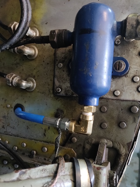

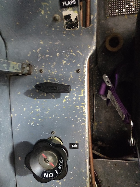

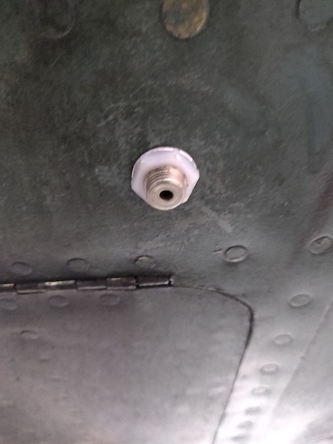

PostPosted: Sun Jul 11, 2021 6:57 am    Post subject: Re: Compressor charging Reply with quote
richard.goode(at)russiana wrote:
I am obviously not making myself clear! I certainly would not recommend a system of pushrods or cables going through the firewall to turn the water drain tap. What we do is to move the entire water drain tap into the cockpit, typically just below the pilot seat so the tap can easily be opened or closed from the seat. Then the water drain – obviously a small metal tube – extends through the floor of the aircraft. Like this, the opening and shutting of the tap is totally positive as it would be on the firewall.
After chatting with Richard a year or so ago, I did exactly this, using SS paintball (yes, I know, from China) high pressure lines, and a swagelok valve in the cockpit. It is awesome to release the snot from there, and to unload the compressor. However, I have now ONCE forgotten to close the valve upon entering the pattern. So, one has to change their flow/checklist... I also only open the valve if going on a longer flight, not just some local work.

PostPosted: Sun Jul 11, 2021 8:41 am    Post subject: Compressor charging Reply with quote
Yes, over the years we've installed the systems on many Sukhoi and Yak; it is (almost) full proof, and really does extend the life of the compressor, which, in my view, is the weakest link in the M 14 engine!

easy_driver
Joined: 25 Jul 2020
Posts: 13
Location: Alexandria, VA
PostPosted: Sun Jul 11, 2021 11:53 am    Post subject: Re: Compressor charging Reply with quote
there is a reason why sump bottles are located near compressor heads. by moving it away you turn the air line into a sump.
instead of reinventing a wheel - put back AD-50 charge controller. it is on the original air system diagram.

PostPosted: Sun Jul 11, 2021 3:04 pm    Post subject: Re: Compressor charging Reply with quote
Stephen, when you action your snot valve in the cockpit, what do you see on your Main Air gauge ... I mean what happens ?
Sean Trestrail

markbitterlich(at)embarqm
PostPosted: Sun Jul 11, 2021 6:41 pm    Post subject: Compressor charging Reply with quote
Could you please explain that in a little more detail please?  The 3 feet of air line before the standard sump is not a sump. But if  it is 6 feet long it becomes the sump?

easy_driver
Joined: 25 Jul 2020
Posts: 13
PostPosted: Sun Jul 11, 2021 7:07 pm    Post subject: Re: Compressor charging Reply with quote
i would guess it's longer than 6 feet. and i would dare to postulate that air moving through small diameter thin-walled tube would loose its temperature. ( design of a heat exchanger )
but if someone wants to experiment - who am i to judge...

Hi Sean,
Nothing. The Sukhoi only had one small bottle to start the engine.
regards
Stephen
PostPosted: Sun Jul 11, 2021 11:28 pm    Post subject: Compressor charging Reply with quote
There is no reason that the main air pressure would change at all. The system has a non-return valve between the compressor and the tank, and the gauge is measuring tank pressure. So when you release the water-drain, all you're doing is to let out the water and the small amount of air that is in the drain system.

PostPosted: Mon Jul 12, 2021 12:01 am    Post subject: Compressor charging Reply with quote
As usual Richard is correct. There was no change.
I’ve sold the Sukhoi now so can’t give you a detailed description of the set up. But it worked perfectly.
[quote] On 12 Jul 2021, at 09:28, Richard Goode <richard.goode(at)russianaeros.com> wrote:

dsavarese0812(at)bellsout
PostPosted: Mon Jul 12, 2021 12:44 am    Post subject: Compressor charging Reply with quote
What Richard is telling you is that the drain works exactly the same as the original drain. It (the drain) is just relocated to a more convenient location.
Dennis
