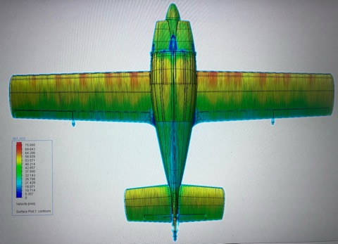

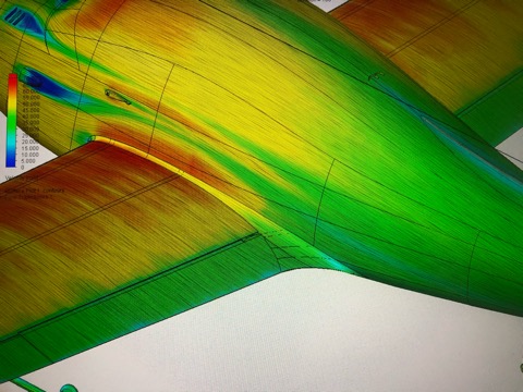

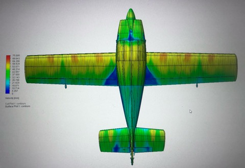

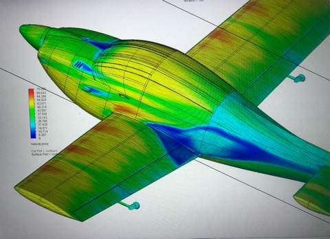

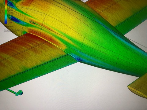

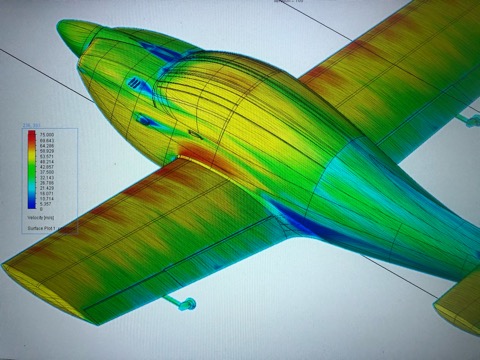

Went back into the digital world between helping clean up flood damage and waiting for flying conditions to improve.
Decided to see what wing root flares do in cruise config at 100kt and 0deg attitude; short answer, not a great deal... they look pretty and clean up the air flow. The gains in drag reduction are minor compared against standard factory config. If anything they probably reduce noise; smidgen of drag reduction and lift increase.
Remodelled the canopy slightly to match actuals closer; thought the sleeker rake would improve performance; surprised to see the data go the other way... and that may change again once an active spinning prop gets introduced into the solution.
So then both models went back into solution at 3deg attitude at 100kt; very different story than 0deg attitude above... the flares provided a drag reduction from 65kg to 45kg with reduced turbulence passing over the tail plane sufaces and lift increased from 675kg to 790kg... so it would appear wing root flares do indeed make a difference with increased attitude.
Excited to see what happens toward stall angle..
