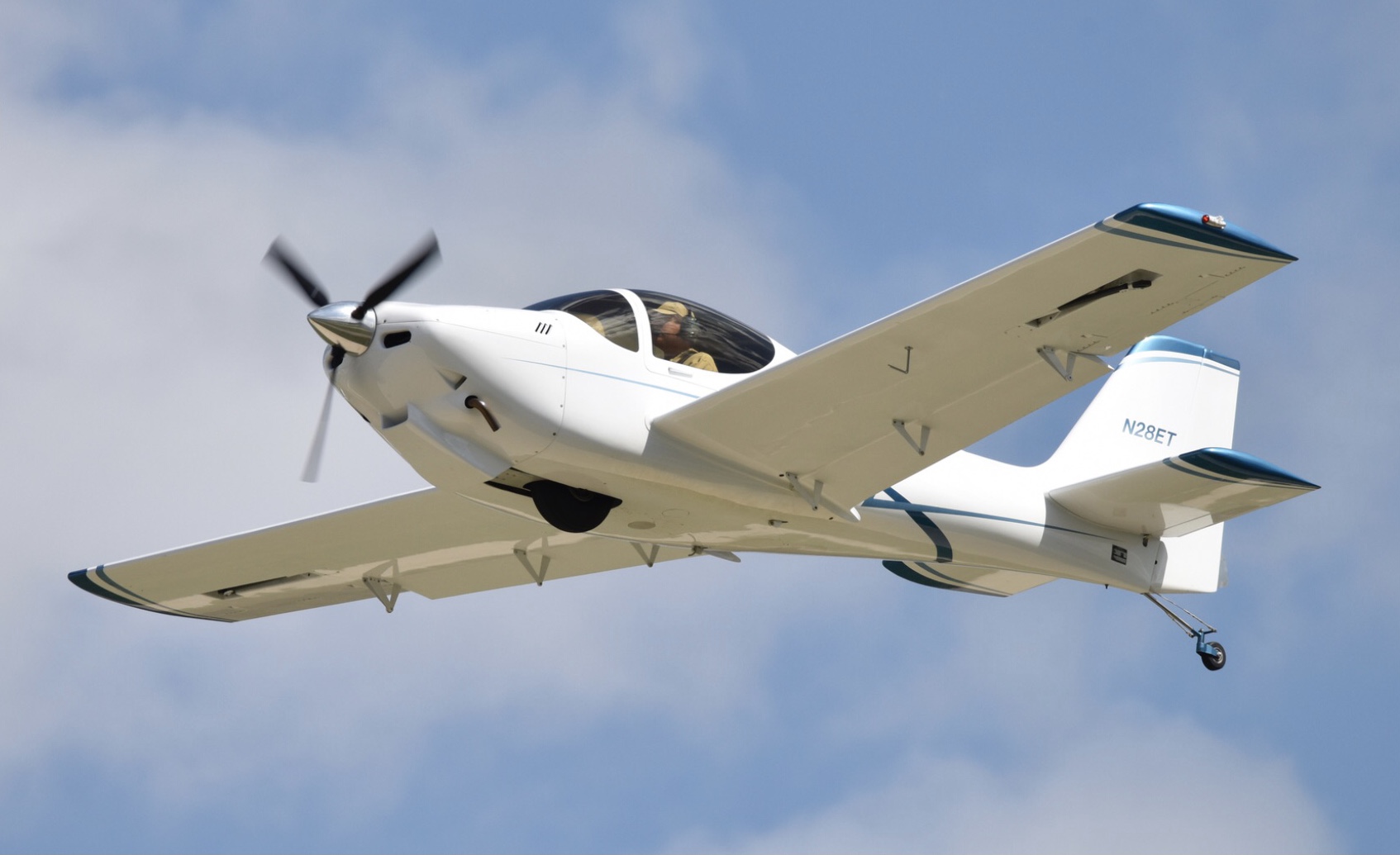

Hello James,
I de-coupled my flaps and outriggers during the initial build. That said, my outriggers are not stock, rather my own design that retract flush into the wings. I use a linear actuator to raise and lower the outriggers which are interlocked with the main gear. For the the flaps I installed the tri-gear flap motor which has worked well. The installation can be done as a retro fit, albeit with a lot of work.
Below is a photo taken at Oshkosh. I had just taken off and was in the process of raising the gear and flaps when the photo was taken. Another second or so and the plane would have been cleaned up. Oh well, it’s still a great photo.
Erich Trombley
N28ET Classic Mono 914

Beautiful picture Erich. I hope mine looks like that one day!
