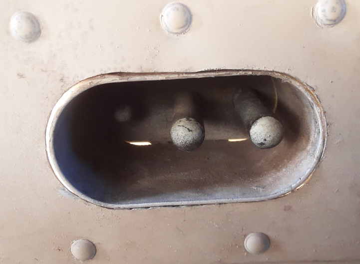

Is this external power receptacle on a Western airplane?  Or a Yak/CJ?
On Mon, May 24, 2021 at 12:27 PM Bob Verwey <bob.verwey(at)gmail.com (bob.verwey(at)gmail.com)> wrote:
Thanks for the responses to my query....I now have the right solution.
Any recommendations as to how to tie this receptacle into the schematic?
[img]cid:ii_kp2ux4b70[/img]
More specifically the polarity relay that is indicated.
Best Regards,Bob Verwey
