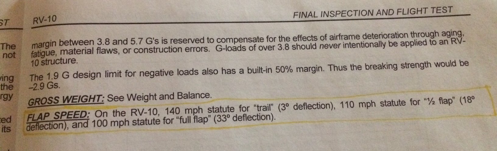

The original source was found in Section 5 of Vans plans. In my book it's on page 21. (SN 40750 - I heard it may have been omitted in later versions).
They provide speeds for the trail position, then half, then full.
I plotted the trail position (0° by my reference), flaps half (15°) and flaps full (30°) on a chart and determined where 10° and 20° would fall on the curve.
So on my airplane I have -3° (reflex), 0° (Trail w/ airspeed limitation), 10° (w/ airspeed limitation), 20° (w/airspeed limitation), and 30° (w/airspeed limitation).
I just did the math using their data to give me a few more flap choices along the way.
Phil

 Filesize:  277.43 KB
 Viewed:  40978 Time(s)

PostPosted: Tue May 04, 2021 6:16 am    Post subject: RV-10 flap extend speeds Reply with quote
That's what I like to see.  A man with solid data. Wink  Thanks Phil!
For those who are in probably the majority, who use KTS, that's:
122 kts   0 degrees
96 kts  18 Degrees
87 kts  33 Degrees
These are rounded UP (less conservative) by less than 1 kt.  Maybe if you
have the ultra high precision airspeed indicator with 3 decimal point
resolution, and are a zen master RV-10 pilot, you can do the original math and fly
the .1 to .5 kts slower so you don't over speed the flaps.

Phil nailed it.  It's still in the pdf plans that Van's sends out on a memory stick.  I got one earlier this year.
--Dave Saylor

As several posts have said, 122/96/87 kias are the posted speeds in the documentation of older -10’s. However, not too long ago Vans removed the restriction on ‘in trail’ (0 deg). The limiting factor was the flap extension arm, and they decided it was strong enough up to Vne.
I’ve done just a bit of experimentation with cruising with the flaps in trail, at higher altitudes. With a modest load (400 lbs in cabin, 3/4 fuel) at a density altitude of 17,000’, going back and forth between full up and in-trail, I thought in-trail might have been a knot or two faster. There was just enough turbulence that I couldn’t say for sure. I spoke with Steve, the wing designer, and he confirmed that high enough and heavy enough, you could expect in-trail to work better.
