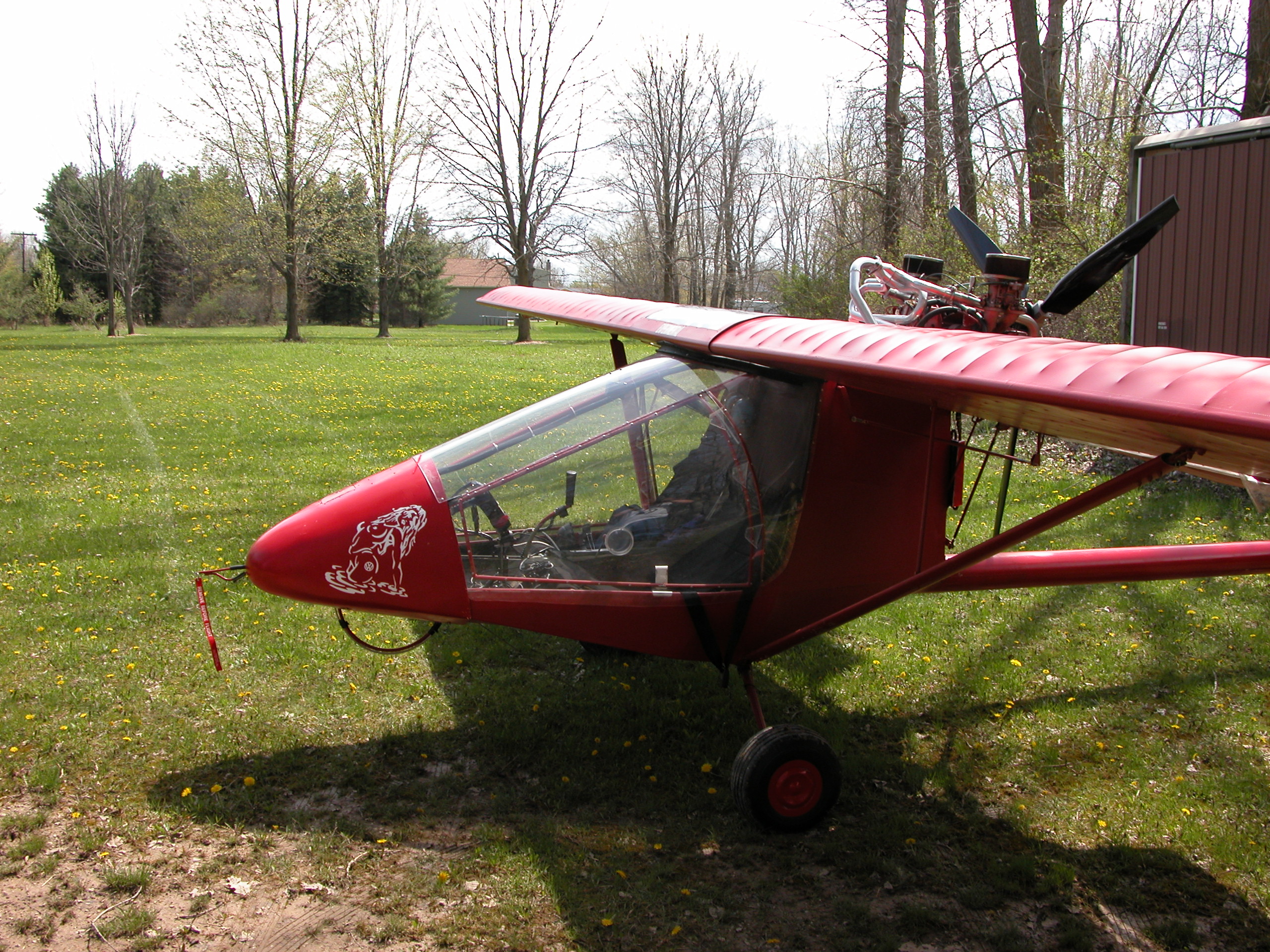

I'm working on my FS2 I bought partially completed.  The previous owner did a pretty good job on most everything.  However, when inspecting the wings I noticed if I lay a straight edge on the nose of the ribs and the end of the rib (just in front of the rivet) that the straight edge is about 3/32" up above the front spar.  This means there will be protrusions in the fabric at every rib once covered. It sounds like this should have been checked in the building process but got overlooked somehow.
Short of unriveting everything off the leading edge spar and either rotating it (which would be weaker due to the holes) or just replacing it by getting the ribs back just a bit more, are the protrusions something I need to fix?  I know I can tape over each one but is there a better way so the protrusions don't poke through the fabric?  I don't feel comfortable taking a cutoff wheel to the rib protrusions as I could easily damage that leading edge spar with a little slip.

Photos would be very helpful. Most ribs are built by the factory because they were such a good deal and they do stick up a bit. Is it a problem NO. Definitely put anti chafe tape on them. My MKIIIC is app. 30 years old and there are no issues in that area. I suppose one could squeeze the ends of the tubing a bit to make it a bit flat but don't make it worse by weakening the rib.
See the attached photo. Zoom in, the ribs stick up but is that a problem or there by design? Sorry I'm NOT going to compress the photo because you need to zoom in to see the detail.
Worth what you paid for it.
