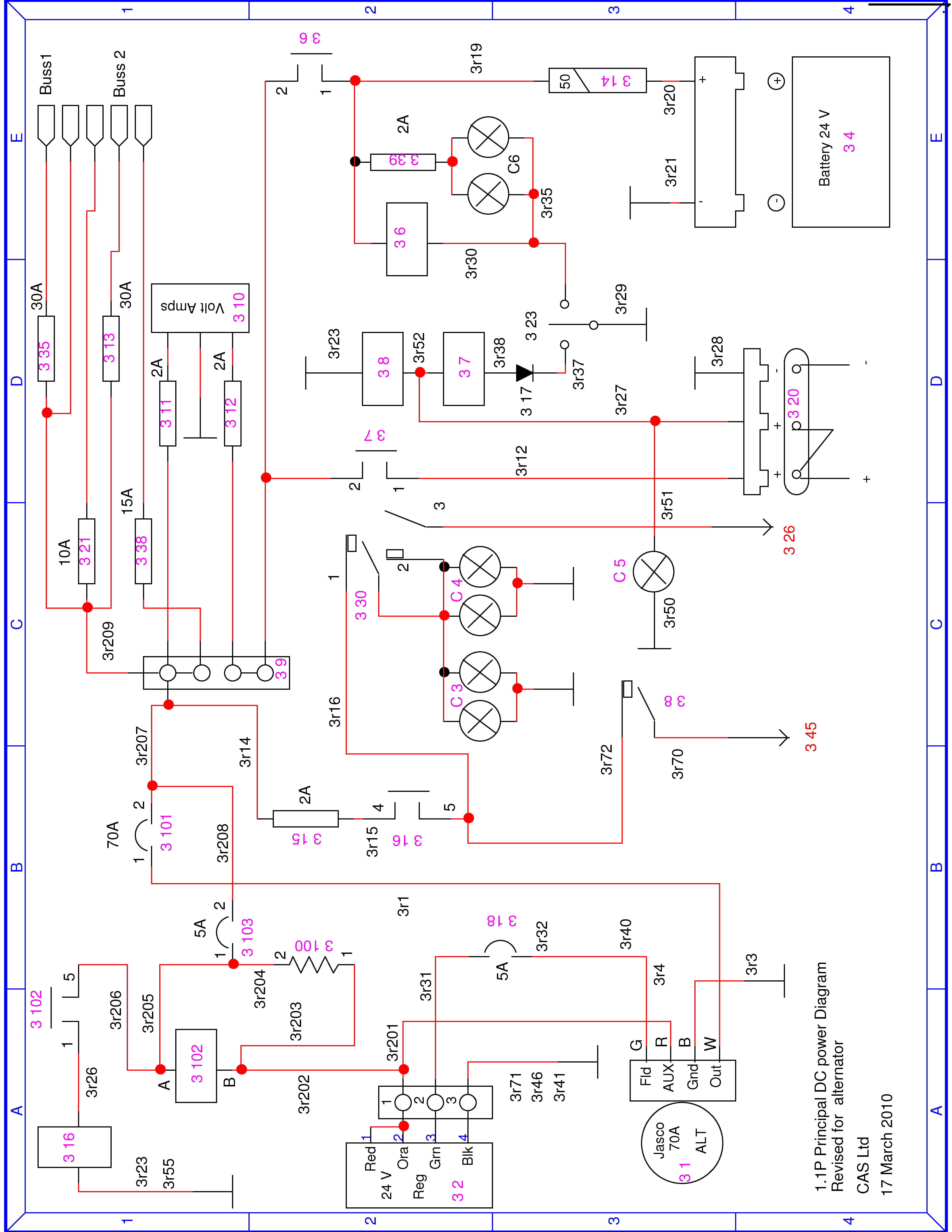

Here is my diagram of the modified electrical diagram. It was for a Jasco alternator. I believe the same sensing as the B&C alternator. You can see that I used a relay to reverse the sensing of the alternator to run the alternator inop lights.
George

The field wire to generator can be reused going to field of Alt.  New circuit breaker will be needed for Alternator output to main bus. Recommend 30 amps or less for SK35.  Wire from main bus through Gen switch in cockpit can be reused, although current limiting is incorrect from Gen switch. You could add a breaker.  Gen light and alt light from ls1a are not compatible.   LS1A is actually a low voltage light need breaker for that. Ls1a provides the ground for the light as I remember and can burn up easily, very very low current rating.  Gen light circuit in cockpit COULD be made to work, but I am not sure about CJ, only Yaks and Sukes.

The generator switch is a JK-1, a pure switch. It can be replaced with a ZKC-5, which looks just like the JK-1 but is also a 5A circuit breaker. The question I have for B&C is whether this switch and CB can be downstream of their LS-1A regulator or if they have to be upstream.
I’m having the B&C regulator drive the existing warning light relay. That relay has a  375 ohm coil, so only about 0.07A draw. I guess I should ask B&C if that’s ok, but that’s a really low draw.
George

I've asked B&C about the light circuit.  70 milliamp is well within spec. That's exactly what I did with Yaks and Sukes. Make sure you have a diode across the coil to prevent a reverse current spike.
The 5 Amp breaker is protecting field current draw. Between bus and ls1a. Not sure what you meant about the other?
One warning, a hard short on the output will take out the alternator. Breakers can take a split second to pop, which is why I put in a lower current main breaker. Your call.

I am saying that the B&C regulator can be used with the B&C alternator by simply cutting the old JTY-1 regulator at the canon plug pigtail and connecting those wires to the right pins on the B&C regulator.
That’s it, that’s the whole install. (Other than replacing the generator itself with the alternator and running the old wires to it).
