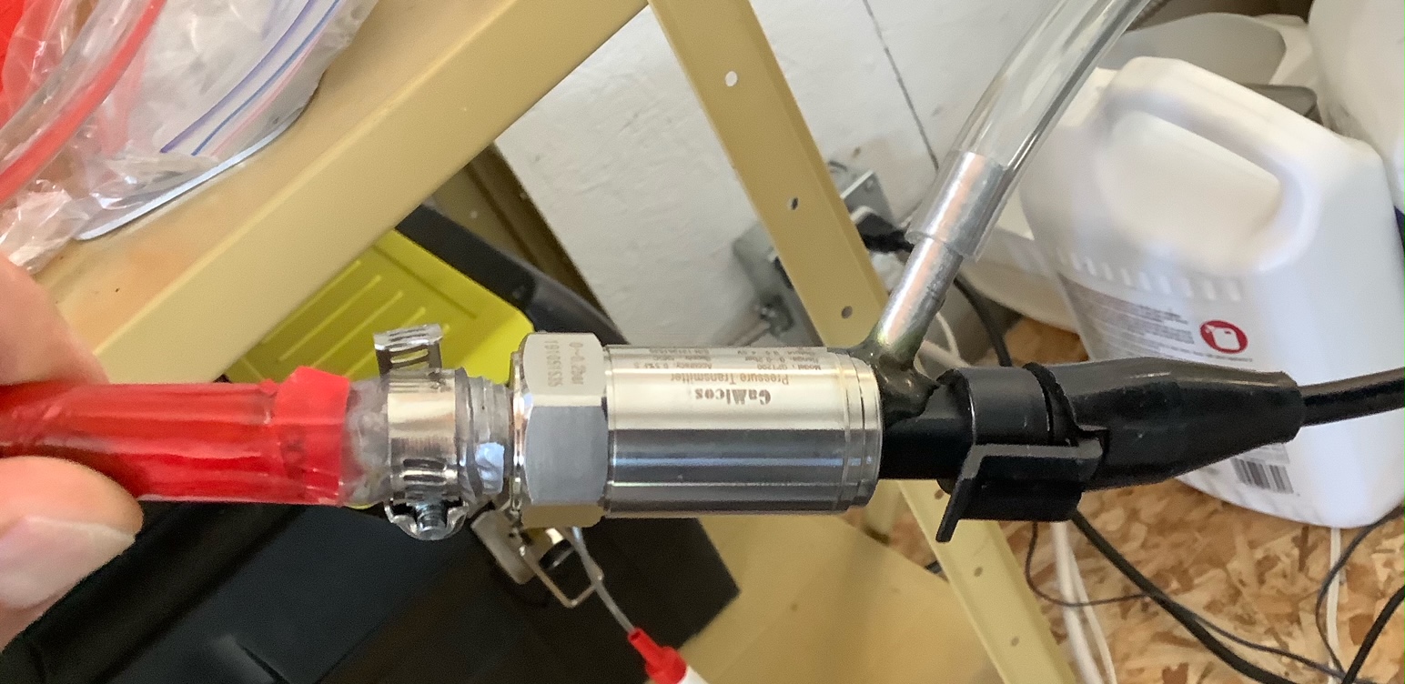

The problem with the BeLite probe is that it is not a differential pressure transducer. The tank vent faces into the airstream and pressurizes the tank. The amount of pressure varies with airspeed. While the amount of pressure from the vent is small, the weight of fuel is also quite small. This will affect the calibration.
I have been using this method of measuring fuel level for many years. I started with the system Tony K from NZ published around 2000. Tony specified a differential pressure transducer. Over the years I have upgraded with newer transducers. After one of my upgrades I couldn't figure out why the calibration in flight was different than that on the ground until I realized about the vent pressure. Changing to a differential transducer solved the problem. I am currently using MPXV4006DP transducers. Since they are not rated for fuel, I use a loop of tubing to force a column of air between the transducer and the liquid.
I agree with Will Daniell, having a tank sensor is not terribly useful. Since the Rotax only uses about 5 gph, you need accuracy of 1 gal to judge 12 minute endurance. That's difficult. The better solution is to use the "main" tank and as it gets low, monitor fuel pressure. When fuel pressure starts to drop, switch tanks. You can easily do this, especially with an EFIS, and the engine won't miss a beat. Then you have the 3 gal in the reserve side, roughly 30 minutes to land.
As always, just my opinion and experience.

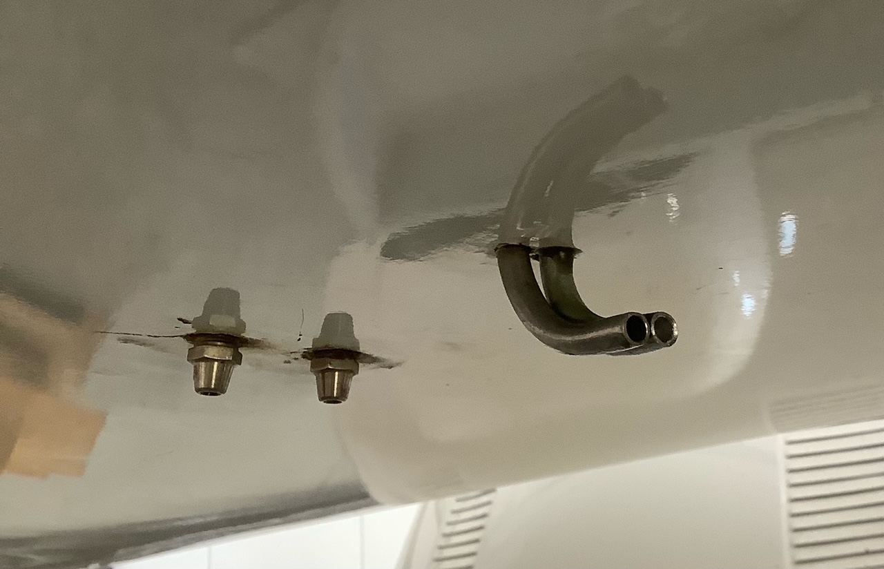

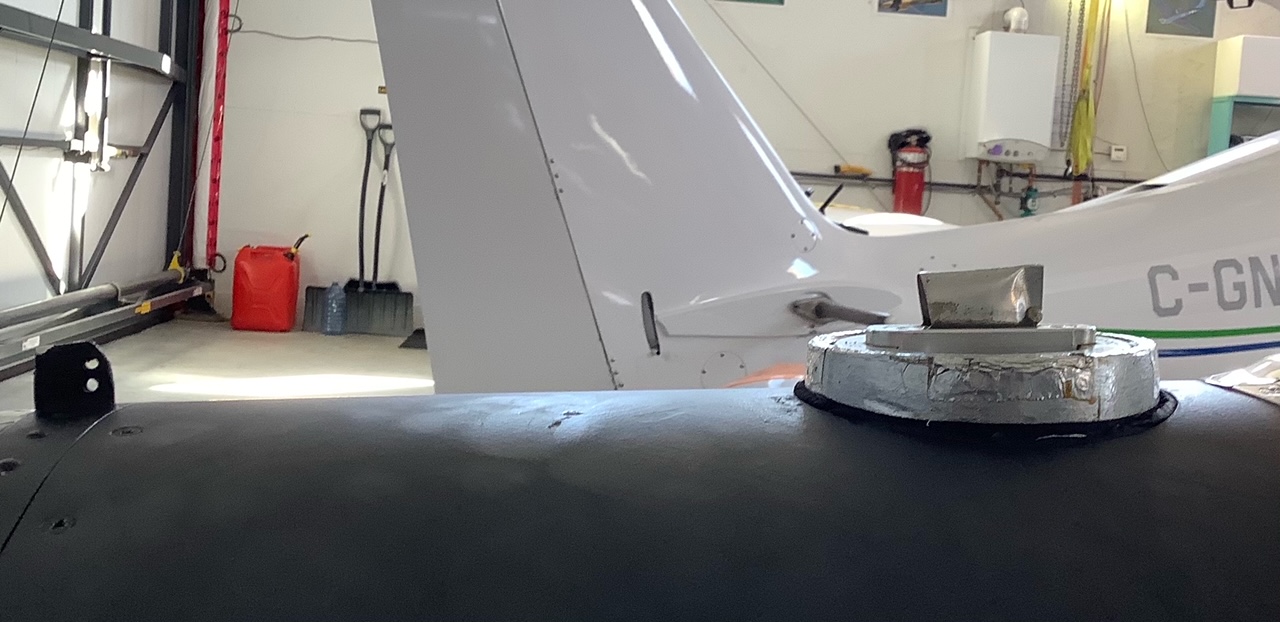

peterz(at)zutrasoft.com
PostPosted: Tue Mar 09, 2021 9:44 am    Post subject: Mod60 Reply with quote
As per my original reply, i added an equivalent pitot feeding the static port of the belite sensor on both aircraft. Easypeasy and works great. Fuel rated sensor. Quite accurate. Satisfied with both.
