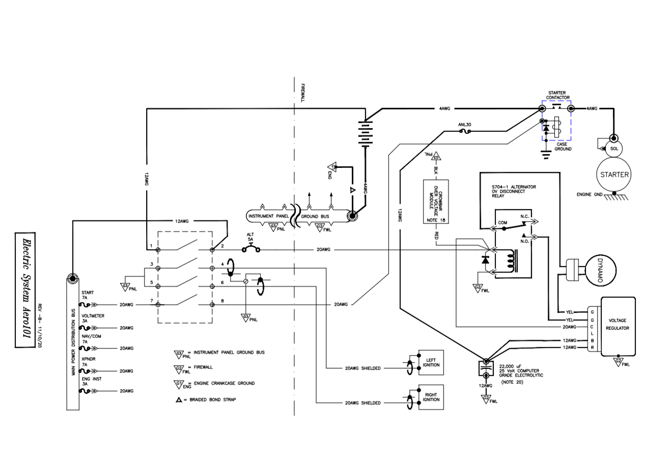

Hi everybody
Many thanks for all the help I received when I designed the electric system for my Jodel's friend.
The plane is now airworthy and so far everything is working like a charm.
I now start helping an other fellow aviator who'w building an Aero101. He is a professional carpenter and the airplane is a true beauty but electicity is not he's strong skill.
I designed a very simple electric system, 90% inspired by bob's Z16.
Once again Bob [and all the other members of this forum], thanks for all the knowledge you're spreading...
My friend had 2 requirement that forced me to differ from Bob's design :
- he doesn't want to use a battery relay (I personally don't neither the load on the bus is less than 5Amp and a simple switch can handle that kind of current)

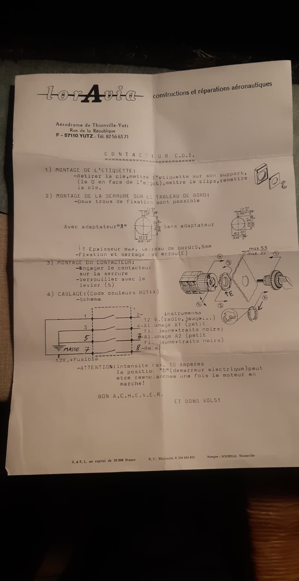

- he bought a rather expensive start key (see installation manual attached) that permits to turn ON the battery, select Ignition 1 and/or 2, and activate the stater. He don't want any other switches (unless safety mandates).
Initially, the supplier doesn't advised to install a OV disconnect relay, but I used Bob's design to adapt one on his airplane.
Please let me know if you see any flaws or improvement possible.
Many thanks

The crowbar module will short out the battery.
There is a long, always-hot wire connected between the battery and
terminal 1 of that expensive switch. In an accident, that wire could make
sparks and start a fire. A battery contactor can shut off power close to the battery.

Thanks for your and Bob's wisdom...
Guess we're always learning...
I've taken into account the suggestion of the battery relay, explained the argument once again, leveled pros & cons but it still a no in this situation.
Moved the crow bar.
Should at least work as it's intended...

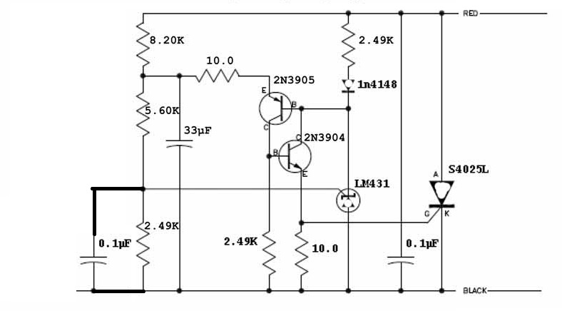

PostPosted: Wed Feb 24, 2021 4:01 pm    Post subject: Re: Peer review, Z16 Rotax engine, Ducati Regulator Reply with quote
Crowbar Over Voltage Circuit

PostPosted: Wed Feb 24, 2021 4:07 pm    Post subject: Re: Peer review, Z16 Rotax engine, Ducati Regulator Reply with quote
http://www.aeroelectric.com/DIY/DIY_Crowbar_OVP_F.pdf
