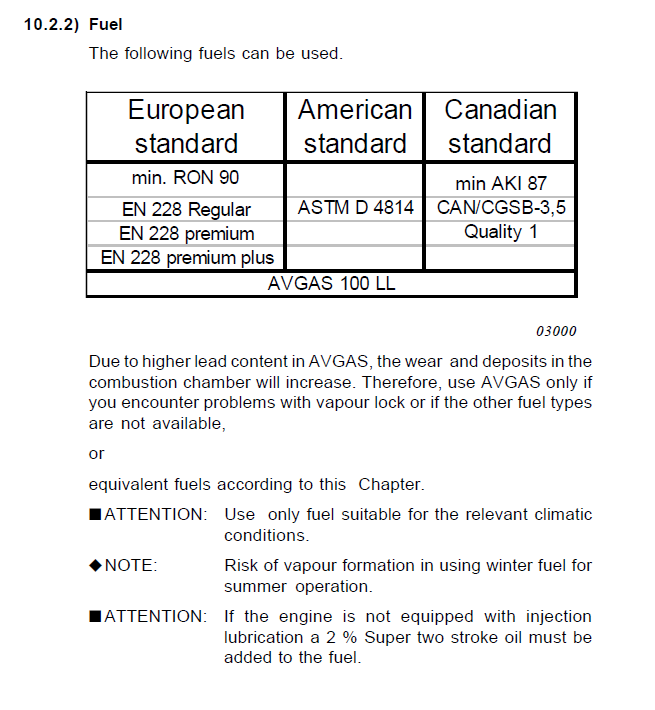

Hi Ed,
I can’t help you with the trailer but here is what my manual says about fuel for the 447, 503 and 582 engines. Based on this I would say no to the 80LL but 100LL is OK.

Ed,
Where in southeast PA are you?  I my fly a FireFly out of my air strip in southern Lancaster, Hideaway Air Park, 14PS.  I can"t help you with a trailer, but have several friends that fly Ultralights here and in Lebanon County that might know of one.  I don't know about 80LL, but I fly all the time on 87 regular fuel.  Not an issue.

I'm in Northern Montgomery Country. I figured I better start looking around for a trailer it's getting warmer. This plane has already flown so most of the pieces are here. I had tygon fuel line and a primer bulb. Are things different now? Is a facet pump better? Then I need a battery.?
The answer to the Original question about 80LL gas is, Don't try it, it won't run. Did they get rid of that?
