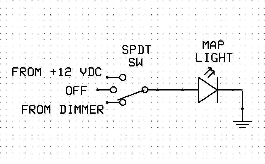

Jeff had a good idea. Below is a schematic of his suggestion.

The problem is my Map Light rocker (already in the panel) is a two position DPDT switch. I should have mentioned that. I think my diagram works given that fact.

PostPosted: Thu Mar 04, 2021 3:27 pm    Post subject: Re: Multiple switches on the same light? Reply with quote
If you use the 2 position switch, move the other light from switch terminal 5 to
terminal 4. The other light will always be controlled by the dimmer regardless
of the switch position. The map light will either be full bright or controlled by
the dimmer but never off.
