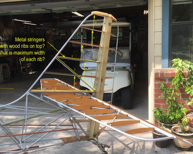

I'm hearing stories that builders are experiencing
'satisfactory' performance with vhf comm antennas
embedded in the structure of a Kitfox vertical
fin.
I'd like to better understand the physics of
this location a bit better. I've attached a
photo of a Kitfox vertical fin sans fabric.
Would you folks with access to a 'naked'
structure tell me what dimensions apply to
the items labeled in the attached photograph?
Thanks!

A couple of notes... This installation would only be possible in a Kitfox with the optional airfoiled tail, which adds wood ribs to the steel structure. Otherwise the vertical stab and rudder are flat sided and there is no room to pass an antenna vertically within the stab. When installed, the ribs are only there to shape the fabric and are not structural.
I bought my project from its first builder, and the tail ribs were already installed. It was very messily done, but the ribs are firmly attached so I did not remove/replace them. Their location is specified in the build manual, but accuracy obviously depends on the builder. These measurements are from my example:
A: 6-1/2"
B: 6-3/8"
C: 6-1/8"
D: 6-3/8"
E: 19" (sits on 3/8" dia steel tube)
F: 22-1/2"
G: 27" (widest rib; sits on 7/8" dia steel tube)
H: 6-1/4"
The ribs taper from 3-3/4" wide at the bottom of "A" to 1-7/8" wide at the top of "H".

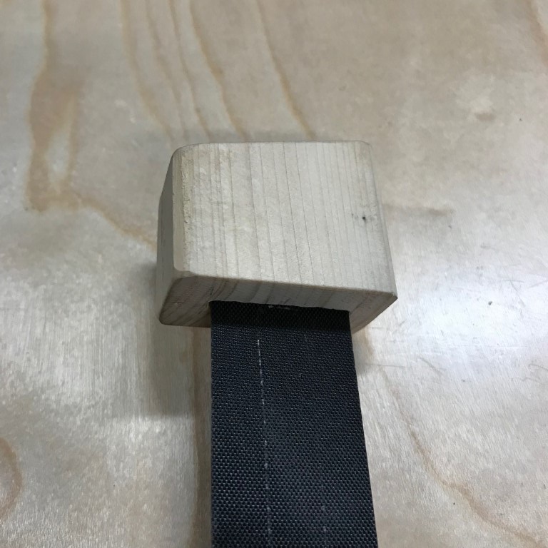

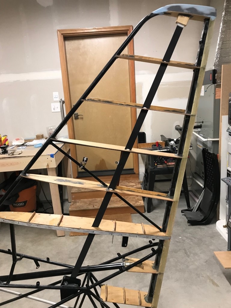

I'm attaching some photos of how I did my installation. I fabricated a wood block with an angled end that would direct the antenna with equal spacing between the forward and aft tubes in the stab. The wood block has a slot in the bottom end to receive the antenna, which is secured with a fillet of caulk.

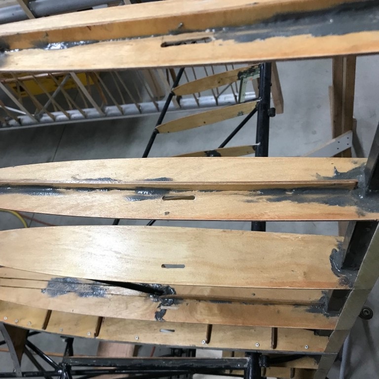

Each rib has a 1" slot, through which the antenna elements pass, again secured with a small dab of caulk to prevent chafing. The center feed point falls in the space labeled "B" in your photo, so the coax will be supported by Adel clamps on diagonal steel member "F". The feed point is secured against vibration by a vertical strip of wood bonded to the ribs above and below, and attached to the feed point with a dab of caulk.

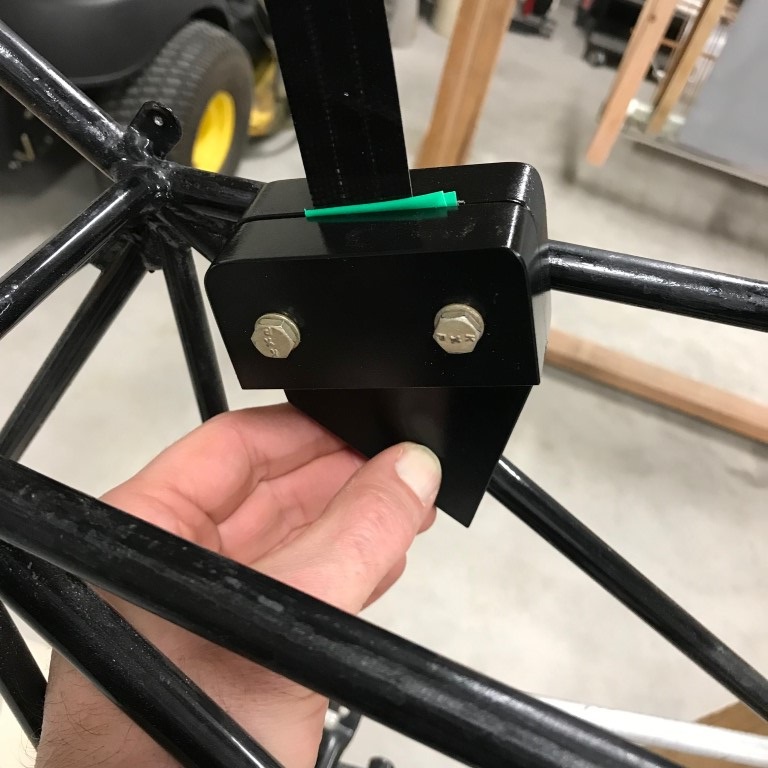

The bottom element of the antenna will be secured by pinching between two small wood blocks, with their inner surfaces lined with a thin rubber sheet for grip. This will be done after the horizontal stab is installed, as the antenna passes through the open center section of the stab.

It took me awhile to realize that the vertical black object going through the
middle of the ribs is actually the com antenna and not structural steel. Is that
a black plastic box at the bottom? What is inside of it? And what is the
purpose of the triangular part that you are holding? Thanks

Yes, the antenna is sort of a fabric tape with, I presume, copper foil elements bonded to it, then encased with a layer of fiberglass and resin. It's about 1" wide and perhaps 0.05" thick.
The "box" and triangular object are the same item: a small block of wood (painted black). It's half of the clamp for the bottom end of the antenna.
The antenna's feed point is a ~1" cube in the center of the tape, located just behind the diagonal steel tube. The BNC is just visible in the "Finished Installation" photo.
