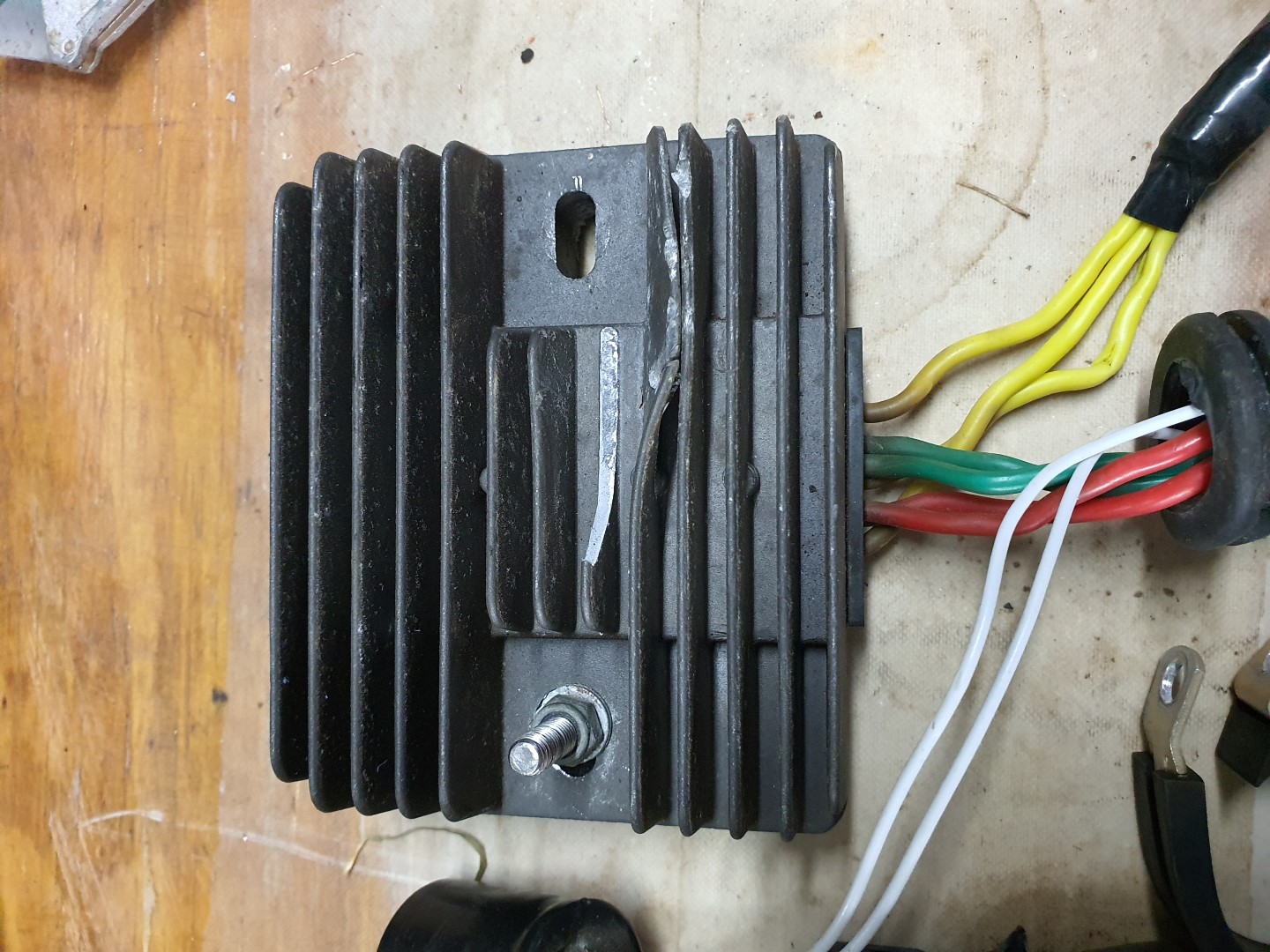

greetings, all
Does anyone recognize this rectifier/regulator ?
It was given to me for my project (Was in a Rotax-powered plane which
was destroyed, and I am busy installing a 912)
Only 2 of the three yellow wires were connected - I assume they were
/are for a 3-phase alternator, whereas the rotax only has 2 wires from
the alternator coils ...
The 2 red and 2 green are terminated in a 2-pin male and a 2-pin female
molex-type connector - I assume they are +ve and -ve to the battery
the 2 white wires in the pic are a 20,000 uF cap, 25v
Can I test the functionality by supplying 9v, 50Hz from an isolation
transformer, and connect the red/green pairs to a gel 12v battery ?
There are no markings or numbers of any sort on the unit
What would be the simplest way to have a charging/not charging
indication - an idiot-light would be my preferance
Charles

Hi Charles
It kinda looks like a Silent: https://www.silent-hektik.de/UL_R_912.htm
Sorry I don't know too much about the unit. You may be able to obtain what you need if you translate page? I believe Vans Aircraft now sells them for their RVs, perhaps you can see if they can help? On my 914 I'm using a B&C AVC1. AVC1 has low voltage warning, over voltage protection and adjustable set-point. You can also set the voltage that the low voltage warning comes on, I'm using LiFe so it really wants to be higher than that used for lead. Ron P.
user9253
Joined: 28 Mar 2008
Posts: 1978
Location: Riley TWP Michigan
PostPosted: Wed Jan 27, 2021 10:49 am    Post subject: Re: Rectifier/Regulator Reply with quote
Charles, is your alternator a single phase permanent magnet type? If so, buy a
new AM101406 regulator from eBay for $19 and free shipping. Mount it with
heat conductive paste and keep it cool with an air blast tube. That is what I
did and it has lasted 4 years so far. The wires in your picture look heat
damaged where they enter the case. Your old one can not be tested with 9
volts. A 16 volt transformer might work. But why bother when a new one is inexpensive?

If you install an AM101406, connect as follows:
B+ goes to the main power bus through a 30 amp fuse.
The AC terminals connect to the dynamo.
Terminal "L" is for an indicator lamp.
IGW gets battery power through a switch labeled "Alternator".
