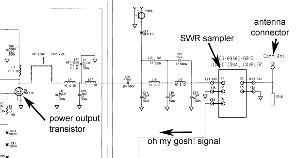

Another thing to consider is keying-up a transmitter without an antenna.
In the old days you could damage the output stage of the transmitter
without an antenna load. Another Lister with more knowledge about
transmitters might provide more info.
That's sorta true in the vacuum tube days . . . but
still valid for long intervals of unloaded transmission.
Early solid state transmitters were germanium transistors
and fragile compared to modern FETS. It wasn't an
instantaneous thing but yeah . . . long-winded 'tests'
were hard on them.
This also pre-dated built-in SWR monitor circuits that reduce
or shut off drive to output stage if poorly terminated. There
probably hasn't been a VHF Comm transceiver in the last
40 years that doesn't have high SWR protection.
