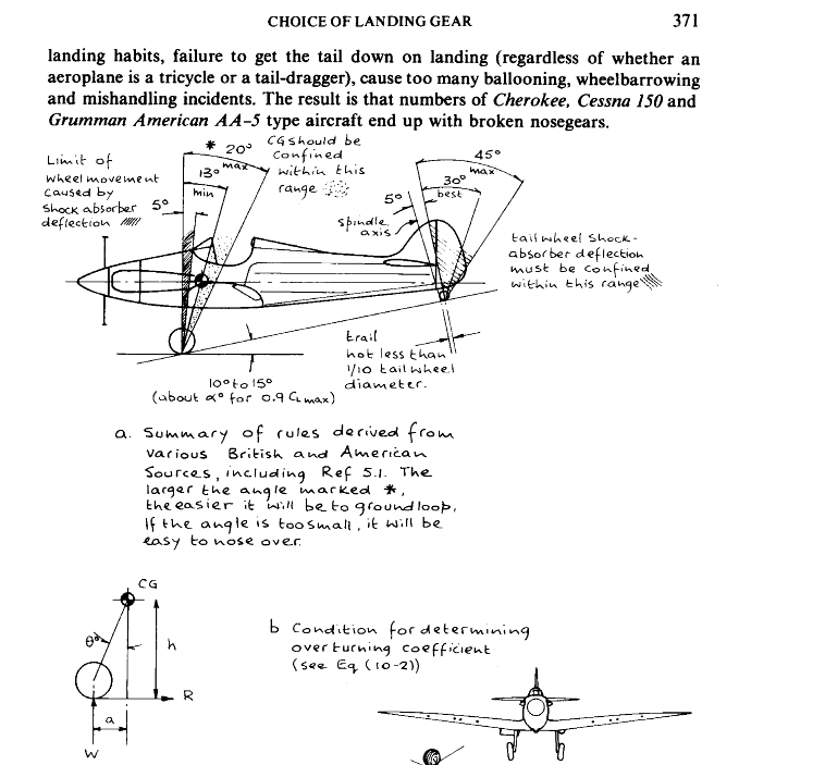

You directed the question to Bud, however, I have some input that may be of interest.
Inevitably things are more complex than just quoting a single dimension. What might be true for a Taylor Titch will most likely be incorrect for a DC-3!
I recommend you obtain a copy of Darrol Stinton's excellent book "Design of the Aeroplane". I attach an extract (with due acknowledgement and credit to his estate) that may help. I do recommend you get a copy of the book.
Pazmany also deals with these matters, books available from the LAA (and elsewhere).
John

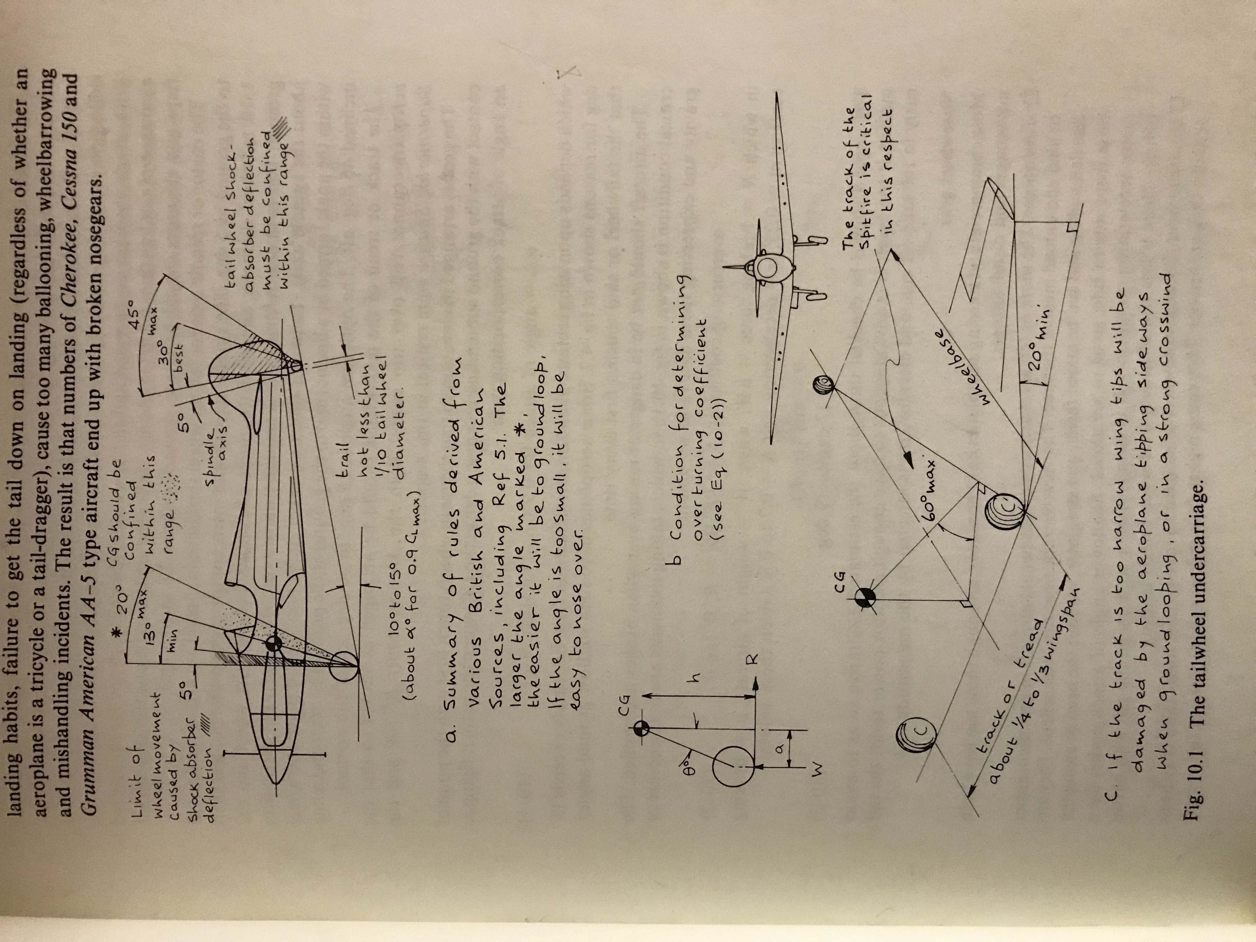

You trimmed the bottom of the page off John.
Here is the full page, I've been looking at it recently and the bottom image is relevant too.

It is controllable, longitudinal wise.
Not unlike the early Maule and Pilatus with their forward placed gear, the planes were reluctant to wheel land nicely.
The mono I have discussed before. There are problems with a low stance fully flapped plane approaching ground effect so as one would expect just looking at the aircraft. It will be reluctant to wheel land easily as the CG to gear to MAC places the gear a bit forward. At a point where the downwash on the tail plane is diminished by the runway, this causes the nose to drop (many folks just never see this effect), the main wheel then contacts the surface first. As the main wheel contacts, the tail drops due to momentum of the CG to main wheel distance, the tail drops increasing the angle of attack and the springiness of the gear shoots the plane back to a flying attitude again and the prudent pilot will go around. My reflexes aren’t quick enough to stop this near landing speed. With a lot of speed it can be done but then there are other problems being at speed on the ground in the mono.
The mono will delightfully obey a tail wheel first landing if the pilot anticipates the stab unloading due to downwash. It is not happy being stalled and dropped in, especially if slightly askew to the alignment. I’ve written how I land the mono. That method works for me. I have access to a long runway and use it to slow flight my way to feel my way to a nose high three point (two point) landing tail wheel first. Others, on short runways, come in slow I’m told (at about 55 Kts) and are able to round out tail wheel first and as the plane “settles� they hold the nose up and stick it. This requires deft skill and comfort in their aircraft.
In testing with the stall strips, this was an irritant to me as the wing would unzip and quit flying just as I needed a bit more lift to stick the tail wheel first. Lee Ohlmernick was patient with me and allowed me to work on my slow flight down the runway until I could see the point where the stab lost its power due to ground effect causing the nose to drop. Keeping the pitch attitude for landing (not allowing the nose to drop) then was just a slow flight technique in ground effect to be mastered. Once I had the motor skill to add the right amount of stick just as ground effect took away a bit of stab authority (keep the landing attitude) touchdowns suddenly became routine. I still go through a ritual on downwind of warming up my toes by quickly adding small amounts of rudder back and forth to prepare my stiff old ankles for the small amounts of movement necessary to maintain precise directional control.
I am not a gifted pilot. It took practice.  It took flying often. It took patience.
Do not neglect the importance of takeoff control either. I have sat through a number of hair raising events in the Mono.  All on takeoff. Tail wheel control is essential. Keep the stick back on power application and be disciplined on directional control. Do not allow any deviation from the centerline.  Once above 35-40 Kts relax the death grip on the aft stick and concentrate on the takeoff attitude (landing attitude) and maintain the pitch attitude until safely slow flighted off the runway and accelerating. Never allow the nose to rise quickly as a stall may occur, maintain the pitch attitude. One can bring the tail up on the main above about 35 Kts, but remember, you are now in a not quite ready to fly airplane and you will need all your flight controls to maintain pitch and alignment until flight speed.  I prefer to just slow flight the plane off the ground. Just as the main wheel begins to extend, hold that pitch attitude and it is delightful even with an 80HP engine and fixed prop. Once off the ground, simply lower the nose a bit to increase acceleration. Never put in full aileron on crosswind takeoffs as the plane will roll quite quickly at the stall. Practice your slow flight at altitude and see for yourself. Cross winds in the Europa Mono are a bit strange to most because it takes virtually no aileron to kick out the crab on landing. Hence on takeoff, full aileron into the wind gives the pilot no feel of the speed and once the nose comes off the ground, the down aileron wing can stall. Slow flight is the key for me. Practicing slow flight at altitude and then again down the runway is how I relearn my mono feel.  If I can fly 1000 feet down the runway in the slow flight attitude and speed, I can land.
Keep it straight, and the stick back.
Bud Yerly
From: owner-europa-list-server(at)matronics.com <owner-europa-list-server(at)matronics.com> On Behalf Of Pete
Sent: Monday, January 18, 2021 9:30 AM
Subject: Re: Aerodynamicist question - Bud Yerly
Bud,
Do you know where the mono stacks up in these params?
Cheers and thx,
Pete
On Jan 18, 2021, at 9:27 AM, Bud Yerly <budyerly(at)msn.com (budyerly(at)msn.com)> wrote:
From history Paul.
Raise the popular tail wheel aircraft and note the position in level attitude of the main axle to the leading edge of the mean aerodynamic chord.
If you drop a plumb bob from the leading edge of a say a 7AC Champ or Citabria (rectangular wing so the mac is the leading edge)  the string goes through the axle.
There are many aerodynamic effects as well as geometry effects to positioning landing gear for a delightful conventional setup.
As you push the stick forward, the main wing begins to go negative preventing nose over as the tail cannot overpower the wings negative lift.
The gear length allows a very near stall attitude at touchdown.
The elevator position is such that it is above the wing downwash at touchdown for stalled landings.
Rudder area is such that the rudder can control the aircraft below stall speed.
Fuselage area vs tail area and sideslip capability for crosswinds.
Geometry is important also. Much has been written:
The angle of the gear to the CG to the vertical CG axis longitudinally.
The angle of the gear to the CG laterally for stability.
Tail volume and length in relation to the gear. (AKA short coupled)
Tail wheel to main gear distance in relation to gear width.
Main gear movement in relation to touchdown forces (splay, compression, springiness etc.).
All these things determine whether a conventional gear aircraft is delightful or a handful to land.
Best Regards,
Bud Yerly
From: owner-europa-list-server(at)matronics.com (owner-europa-list-server(at)matronics.com) <owner-europa-list-server(at)matronics.com (owner-europa-list-server(at)matronics.com)> On Behalf Of Paul McAllister
Sent: Sunday, January 17, 2021 10:16 PM
To: europa-list(at)matronics.com (europa-list(at)matronics.com)
Subject: Aerodynamicist question - Bud Yerly
Hi Bud (and anyone else who is knowledgeable on the topic)
I was once told l that there is an ideal front wheel position for tail drggers, something like 100mm in front of the MAC and that wheel placement of the mono was not ideal. I can't remember where I heard this or if it was from a knowledgeable source.
Would you happen to know if there is any validity in this?
Thanks and regards, Paul
