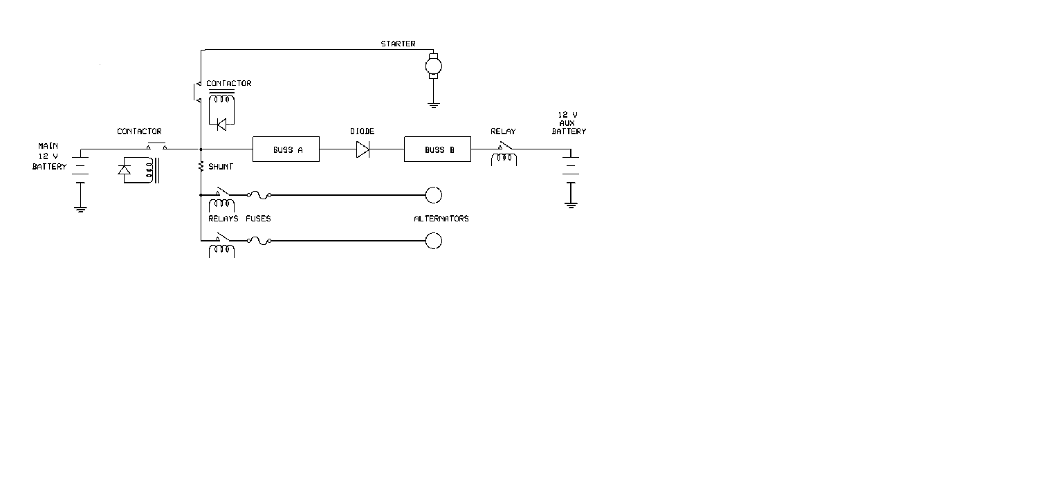

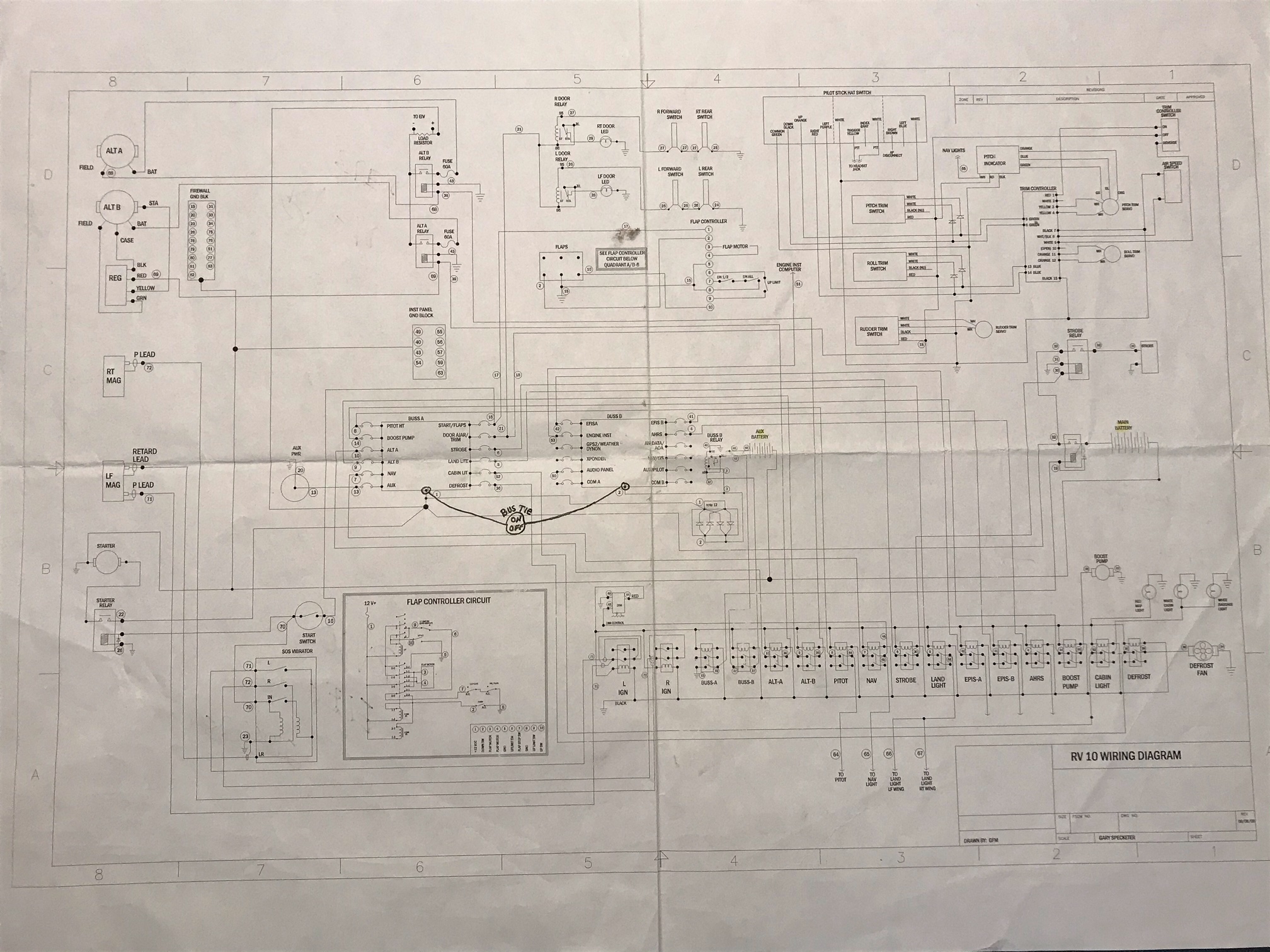

Hey guys I am way in over my head on this forum but a nice man from BandC suggested I try. Attached is the electrical diagram of my recently purchased RV10. It was completed in 2009 and the avionics was switched to a Garmin 900x a year later. My issue is it safe and operationally sound. It is an X design, if that is familiar. Apparently the builder added a bus tie in order to bypass a diode bridge rectifier type because the draw to recharge the Aux Battery, 2 wheel chair batteries 7Ah 12v wired in series reduced the essential bus voltage to 12.6v. This bus tie when on,boosts both busses back to 13.6v. Is this how it was meant to be run?Additionally with both alternators on, the displayed alternator amperage seems to be all over the scale; sometimes 45-50 amps when the airplane has most accessories off. Feeding both alternators into a single “bus bar” seems to cause issues and is that safe?Therefore it’s been recommended that I swap out the Stby Alt for a 60A PP alternator and just use it as the primary power source.  My preference would be going to a Z plan where each alternator powers its own bus but I’ve been advised against that. The good news is my A&P figured out the shunt had not been changed per Garmin install instructions, a [url=x-apple-data-detectors://0]100A[/url] 50 milivolts currently on order.Sorry for the length of this & the formatting issues. [img]cid:6752740E-5AA5-45C2-8517-DB2B2E3E319D-L0-001[/img]

On 1/10/2021 7:06 PM, WILLIAM BOOTH wrote:
I can add after 6 months of frustration I have learned a lot about my
electrical system.  The shunt off of the alternators is incorrect and
will be replaced this week.  The battery shunt appears to be off by a
factor of 2.5. The Garmin draw with only the battery on and both PFD’s
tested at 7amps draw while the Garmin displayed 17 amps draw.  This
implies to me that it needs a 250a and 50mV shunt.  I plan on
contacting Garmin this week to determine their requirements.
Garmin specs a 100amp 50mV shunt. Certainly if the shunt and efis
settings don't match you'll get inaccurate readings. 7 amps sounds about
right to me. Also, I saw the previous comment about fuses in the middle
of the sense lines. Excess resistance there will also affect the
readings. Fuses are a good idea but they should be right at the shunt. I
used pico fuses to avoid issues with a fuse holder.
--Rick

  That's a REALLY busy electrical system . . .
  The thought processes behind this architecture cannot
  be know to us unless it's documented somewhere. The
  system depicted has features that are
Additionally with both alternators on, the displayed alternator amperage seems to be all over the scale; sometimes 45-50 amps when the airplane has most accessories off. Feeding both alternators into a single “bus bar†seems to cause issues and is that safe?
  Why run both at the same time?
Therefore it's been recommended that I swap out the Stby Alt for a 60A PP alternator and just use it as the primary power source.  My preference would be going to a Z plan where each alternator powers its own bus but I've been advised against that. The good news is my A&P figured out the shunt had not been changed per Garmin install instructions, a 100A 50 milivolts currently on order.
  Aside from the things you've described here has
  this system been flying 'successfully' since 2009?
  Unless the seller offered the equivalent of a pilots
  operating handbook for the system, you're kinda
  stuck with second guessing the builder's original
  design goals.
  The builder spent a lot of time providing a good
  drawing of the wiring which is good. But the arrangement
  makes it difficult to sort out exactly how this
  system is supposed to function. Wiring for
  bridge rectifier is curious . . . it shows all
  four terminals tied together which negates its
  function as a diode array.
  Changing this system to conform to a Z-figure
  would be a BIG task. What are your plans/expectations
  for getting the airplane flyable?

What appear to be relays in the lower right corner are actually illuminated switches.
I do not see any over voltage protection.
While cranking the engine, if the bus tie switch is closed and if bus B switch is closed,
then the aux battery will help crank the engine. Are the wires big enough to
handle the current? The solution is to eliminate the bus tie switch. So what
if bus B is one volt less than Bus A? A Schottky diode will not drop as much
voltage and will not get as hot.
Alternators A and B have their labels reversed.
The strobe circuit needs to be protected by a fuse.
Connecting both alternators to one current shunt is not necessarily unsafe unless the shunt fails.
Consider using individual hall effect current sensors.
If the alternators do not play well with each other, the simple solution is to only have one on at a time.
If the original builder practiced good workmanship, I would not rewire the airplane.

I would suggest that the battery arrangement in the picture shouldn't have ever
been part of the cranking circuit.   I say this because it looks like that was
a copy of my aux battery config, of which I was the first RV-10 to put them
in that location.  It looks like the liked my location, liked some of the
configuration, but then if they tried in any way to use it for engine cranking,
they took a hard turn and went down a different path than those batteries
would have ever been planned to be used for.
My primary battery is an Odyssey PC925, located in the tail, and it has no
problem cranking the engine all by itself.
People who use PC680's often install 2, in the same rear location, and tie them
together for cranking.  You should probably have someone look over
that portion of your electrical system in particular, and just plan to remove
these by the flap torque tube completely from any engine cranking operation.
Tim
On 1/12/2021 3:07 PM, WILLIAM BOOTH wrote:
I would like to avoid rewiring if possible.
- Over voltage protection I can resolve with a PP alternator (and change it over to the primary?).
- The batteries to help crank not only are not big enough , but the wires are not big enough. (Picture included.)
- A Schottky diode is a great solution but wiring it like my current one would be incorrect as “I” understand it. (Picture included.)
- Great catch on the mislabeled alternators; I saw that too.
- The Hall effect current sensor; is that a directional flow item, like a diode?
- Yes on the one at a time and only keep the other one for STANDBY use.
William Booth
Sent from my iPad
On Jan 12, 2021, at 11:42 AM, user9253 <fransew(at)gmail.com> (fransew(at)gmail.com) wrote:
--> AeroElectric-List message posted by: "user9253" <fransew(at)gmail.com> (fransew(at)gmail.com)

BTW what is the purpose of the diode, how is it used and how does the electricity flow thru it?
William Booth
Joe Gores
http://forums.matronics.com/viewtopic.php?p=500156#500156

Think of the diode as a one way check valve. It allows current to
flow from bus A to bus B, but not in the opposite direction.

RE the diode: Specifically why is it needed on this design; how else could the power flow?
Re: Tim’s comment on the Aux Batteries; too small and the wires too small too....
I agree it has puzzled me when I first saw it but if buse B is turned on for start I should be ok? That being said how else should it be done? Again safe and sound is the goal.

Follow the wires from the aux battery, through the bus B relay, to
Bus B, through the bus tie switch, to bus A, to the big dot (junction)
below bus A, to the starter relay, to the starter.
Lots of current will flow through that path. Prevent it by removing the bus tie switch.
And remove that jumper from the bottom of the diodes (labeled 2)
because it also will conduct starter current.
Joe Gores

I redrew part of the RV-10 electrical drawing from post #1 to make it easier to read.

Thanks again Joe. I’m soaking this up as best I can. To me it simplifies the system.
I need to research how to read the relay symbology. The relay on the aux batteries: I assume that as long as there is power to the main buses the relay is open but if that power were to fail it closes and provides power from the aux batteries to the essential bus.
William Booth

PostPosted: Thu Jan 14, 2021 6:34 pm    Post subject: Re: RV10 Electrical Issue (w/ Format Clean Up) Reply with quote
I do not think that the aux battery relay automatically switches on if needed.
It is hard to tell because the drawing is blurry.
But it looks like Bus B switch must be turned on to energize the relay.
