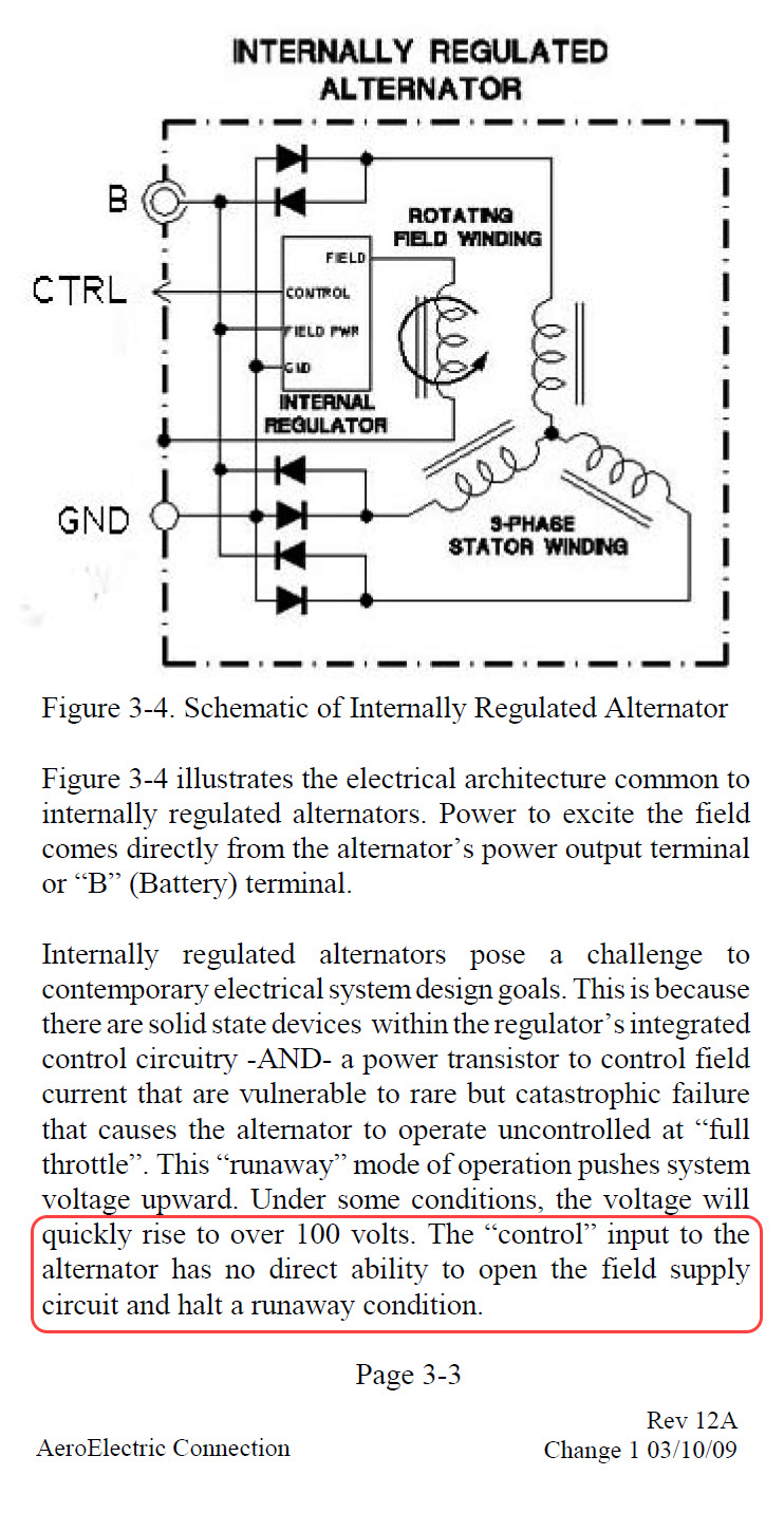

PostPosted: Sat Jan 16, 2021 5:49 am    Post subject: Re: OV relay and crowbar Reply with quote
I don't know about all internally regulated alternators but it is common for the control wire to turn the alternator on but have no ability to turn it off.
In any case, as stated in AeroElectric Connection book: The '‘control” input to the alternator has no direct ability to open the field supply circuit and halt a runaway condition.
Ref attached image snip from AeroElectric Connection book.
 Filesize:  361.78 KB
 Viewed:  7005 Time(s)
John Bright, RV-6A
Single battery, wound-field alternator on main bus, MZ-30 PM generator on engine/essential bus.
