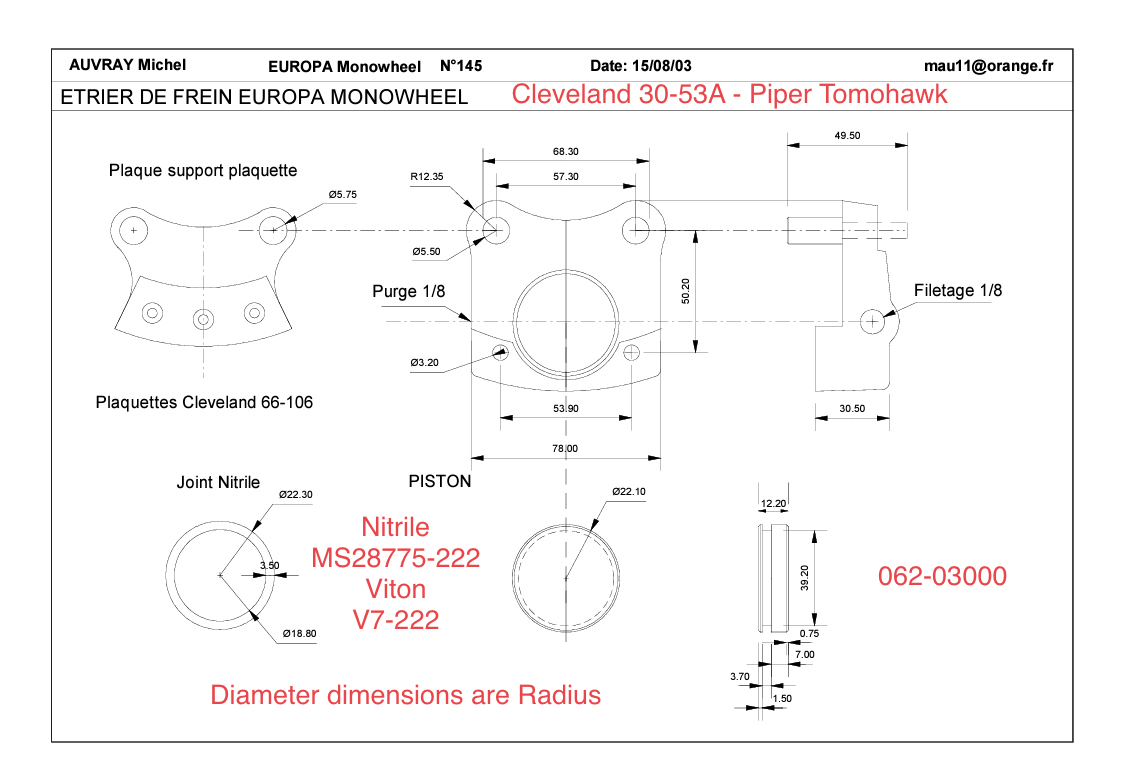

Could someone advise the size/Part No of the Mono slave cylinder O ring please.

Hello Kingsley,
Attached is a drawing from Michel Auvray showing the dimension of this O-ring

PostPosted: Wed Jan 13, 2021 8:14 pm    Post subject: Mono Slave Cyl O-ring Reply with quote
Many thanks for the drawing Remi, you are a handy person to know!
Consistent with the constraints of my ability to accurately measure the
size of the 'O' ring I purchased, it appears mine is the same as the one
in Michel's drawing so I feel more confident now that I have the correct
size.

PostPosted: Thu Jul 11, 2024 11:07 pm    Post subject: Re: Mono Slave Cyl O-ring Reply with quote
Updated Data; File attached...
