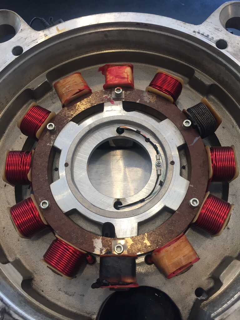

Finally, the last photo is of one of the stators on the Revmaster engine AFTER it failed. I'm told by the pilot (Glen Bradley) that his two stator failures occurred in flight under higher rpms and after the battery (the Odessey AGM) was worked over during a hard start.
HERE IS MY Thesis: I suspect that the stators are experiencing "turn to turn short circuits." This fault mode was suggested to me by another engineer where I work (experienced in these failures) and in his words, "a short between two adjacent wires in the stator is common and one of the most rapid ways a stator will self destruct." (as opposed to a phase to ground fault on a stator)
After a bit of reading I've come up with what I think are justifying equations that would predict the result of shorting a single loop of the stator wire. A single loop of wire on a permanent magnet alternator experiences a circulating current that is at least an order of magentude greater than the complete coil. This rotating conductor (attached to the upstream and down stream stator wiring at a single point) quickly overheats and initiates a cascading failure of adjacent insulation.
If you look at the photo of the burned stator, the 12 O'clock and 6 )'clock coils are stand a lone stators for the redundent CDI ignition. The right five from 1 O'clock to 5 O'clock make up the right stator for the PMA. The left five from 7 to 11 O'clock are the other PMA stator, making up the dual alternator.
I find it more than interesting that only one of the coils making up the left stator is burned while the other 4 appear perfect. Also, the CDI ignition coil failed as well and of course, it is in no way connected to the AGM battery.

With regard to the image of the burned stator:
This should have read "right stator" not left.

Hi Dan,
I read through the earlier post & looked at the images, though I didn't
download the pdf files. I'm certainly no expert, but my thought is that
what your friend said about internal shorting of the coil would be the
most likely failure mode. Heat within a coil would eventually cause
insulation to fail, and once an internal short occurs, there'd be an
avalanche of heat due to the lowered resistance in the shorter path
through the coil.
It seems to me that all the analysis in the world won't help solve the
problem if you can't do anything about the stator itself. Has anyone
done data logging on one of the failed stators prior to, and during, a
real-world in-use failure? Was it asked to deliver more current than the
rated current? Did the associated rectifier/regulator fail at the same
time, or did it survive, and continue to work correctly?
If the rectifier/regulators aren't failing, then you're left with either
an overload (this is what the mfgr is hinting at with the SLA
prohibition), or a rating number that isn't realistic for the stator's
environment (bolted directly to a hot engine block with near-zero airflow).
The brute force cure for stator survival would be to limit output
current with a *current* regulator, set to limit current below the
stator's *real world* capabilities, in its real world environment. The
prohibition on SLA batteries won't solve anything, in and of itself,
because a larger 'wet cell' battery (to achieve the same CCA) could
easily have the same internal resistance as the previous SLA. All
they're really saying is to limit the load current, but they're
apparently unwilling or unable to give a real world number on the
alternator's current capability, in its environment.
FWIW,
Charlie

Fully agree. I am working on investigating alternatives (if the failure is primarily due to insufficient vacuum impregnation of the coils). I will be continuing to collect data on my engine before I run it and plan on continued data collection during operation, should if fail.
I do not believe the associated RR failed during the event that led to the burned coil. Also, I don't believe the 30 amp fuses failed either. This is one of the reasons I was looking (and found) the explanation for the inter coil short phenomenon.
In all failures, heat will contribute to the problem and I think there is a sever lack of cooling of the stator. Something else I want to instrument and test with my engine.
