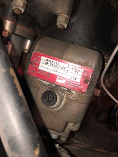

EfraimOtero
Joined: 04 Nov 2020
Posts: 6
Location: Bogota Colombia South America
PostPosted: Thu Nov 26, 2020 3:12 pm    Post subject: Re: Magnetos Reply with quote
cluros(at)gmail.com wrote:
My advice would be to have a mechanic troubleshoot.
In the meantime, is this a new installation that has never run or is this a new problem?
It is an old setup. With a new/charged battery it fired easily. I have to point out that I live in the Andes mountains at 8,535 feet field elevation!

PostPosted: Tue Jan 12, 2021 2:25 pm    Post subject: Re: Magnetos Reply with quote
Neal, thanks for the prompt response.
Mine are Bendix S4 LN -21 mags, P/N 10-51360-30. Are these the same as Continental? Gues not...? Shocked Embarassed

PostPosted: Tue Jan 12, 2021 4:20 pm    Post subject: Magnetos Reply with quote
Yes, they are the same. Continental bought the Bendix ignition line about 35 years ago…
