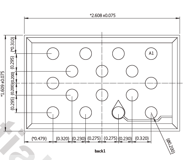

PostPosted: Mon Dec 18, 2023 7:28 am    Post subject: OVM-14 MkIII development (update) Reply with quote
Bob et al...
This is a BGA component (Dims in mm) that is soldered to a slightly larger motherboard.  All our fabs are pick and place. Most boards 6 layers with .010 in traces.  We get some components that are manufactured in millimeters and our design software (Altium) likes inch grids...  The conversion is four significant digits so it's only a matter of making sure you remember what units you are working in...
I only bring this up as boards and fab have really become quite inexpensive. I do 5 piece and 10 piece board proto lots.
Fun stuff!
.Chris

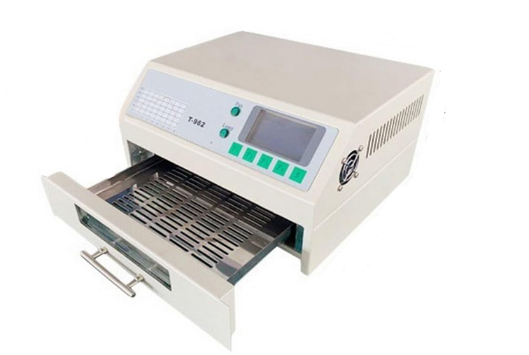

PostPosted: Mon Dec 18, 2023 11:21 am    Post subject: OVM-14 MkIII development (update) Reply with quote
A friend of mine designed and has been making the control
head/monitors for E-Mag ignition systems for many years, using
surface mount components. He copied what hobbyists were doing;
they used a particular brand of 'toaster oven' that has
accurate temperature control. So if you have an E-Mag
control head, it came from an 'easy bake oven'. Wink
Yeah, I've been aware of a constellation of
reflow tools for DIY assembly for a number
of years. About 10 years ago, I bought an
early version of this thing.
Made it work okay . . . but it took up a lot
of room on the bench and was a tool I used
for perhaps an 2 hours per month. It was
just not very practical for my products
with tiny boards. Still had some thru-hole
products that were not oven-friendly.
My little hot-air rework station seemed
to be a better fit for my mix of repair/
manufacturing tasks. Didn't take up much
room. Virtually zero 'set up' . . . one
could visually adjust technique on the
fly. Was a whole lot cheaper too!

PostPosted: Mon Dec 18, 2023 3:07 pm    Post subject: Re: OVM-14 MkIII development (update) Reply with quote
Those Chinese T-962 reflow ovens are well known in the hobbyist community for having hot and cold spots, sometimes poor internal wiring, and for not following IPC profiles very well. There's an open-source project out there for a replacement controller that makes them work better.
I use an old toaster oven with a failed thermostat that makes it run full blast regardless of setting (I ate out the day that happened!). I picked up a cheap industrial ramp/soak PID controller to run it. The only modification necessary was to cover the inside of the window in its door with aluminum foil to minimize radiated heat loss. It now works like a charm and cost only a few dollars.
If you want to build a toaster oven reflow setup, look for an oven with quartz heating elements; they're reputed to allow faster temperature ramps, making it easier to follow the right profile.
-Eric
PostPosted: Mon Dec 18, 2023 7:33 pm    Post subject: OVM-14 MkIII development (update) Reply with quote
At 05:07 PM 12/18/2023, you wrote:
--> AeroElectric-List message posted by: "Eric Page" <edpav8r(at)yahoo.com>
Those Chinese T-962 reflow ovens are well known in the hobbyist community for having hot and cold spots, sometimes poor internal wiring, and for not following IPC profiles ( https://www.ipc.org/TOC/IPC-7801.pdf) very well. There's an open-source project out there for a replacement controller that makes them work better.
Good info sir. Thank you!
I think the T-962 has evolved to mitigate some
of its shortcomings. The one I bought needed
a number of mods right out of the box . . but
it ultimately seemed adequate . . . jut more
than I needed. Kinda like doing in ants
with a sledgehammer!
