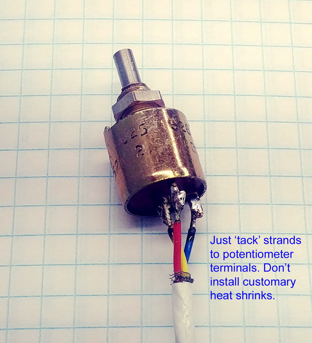

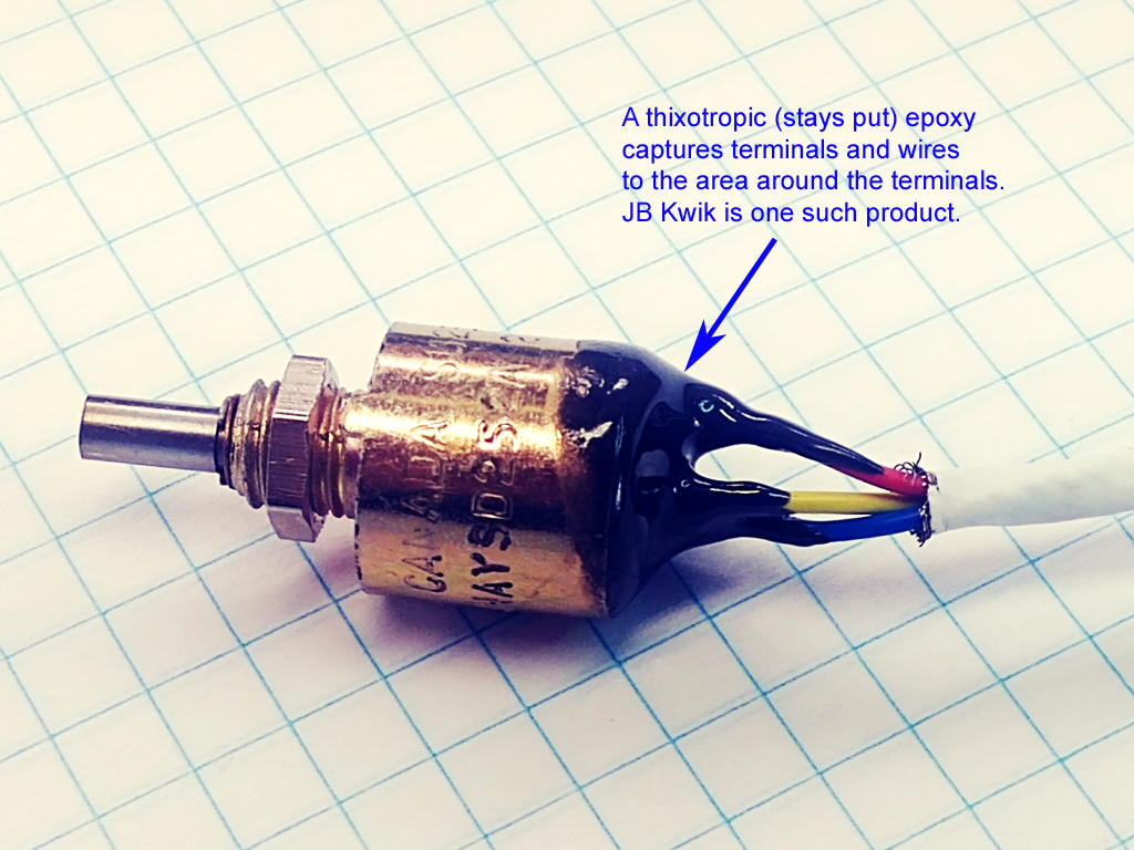

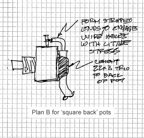

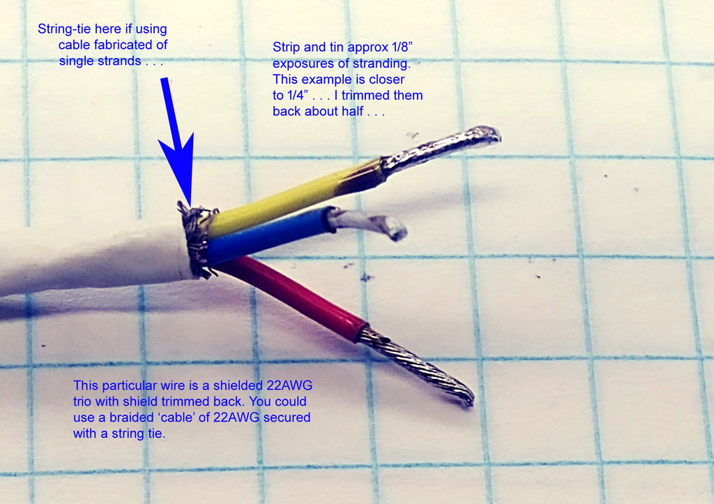

Attached photos illustrate a technique I've
used for a few decades to bring airframe wires
of little buggers like that. My pre-wired
panel potentiometers for the dimmer kits we used
to sell were fabricated with this technique.
Stay healthy and fly comfortably my friend!

Attached photos illustrate a technique I've used for a few decades to bring airframe wires of little buggers like that. My pre-wired panel potentiometers for the dimmer kits we used to sell were fabricated with this technique. Stay healthy and fly comfortably my friend!
<01_Strip-and-tin.jpg><02_Tack-wires-to-terminals.jpg><03_Encapsulate joints.jpg><04_Plan-B for Square-Back Pots.jpg>
