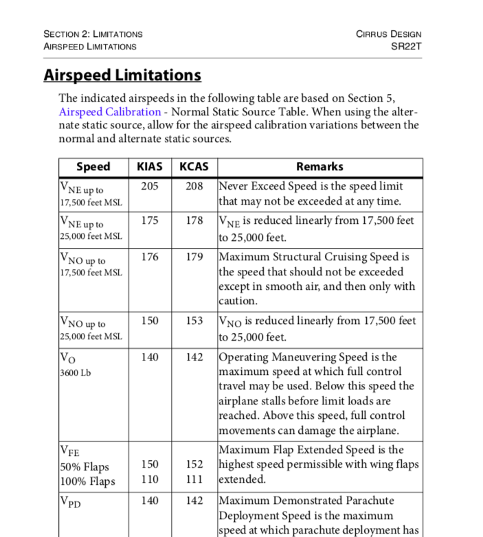

Great article on this critical subject. It would be interesting to find out how the Europa has been evaluated during flight testing of the prototypes, especially at what max altitude the Vd testing has been actually performed.
BTW it is always instructive to look at certificated aircraft manuals and see how they handle any issue. The attached page is from the Cirrus SR22T POH. It shows how they handle the VNE/flutter issue at high altitude. The VNE IAS is reduced linearly above 17500 ft. from 205 kts to 175 kts at 25000 ft. Very few Europas are operated at such high altitudes, but it may be advisable for their pilots to consider reducing their VNE as Cirrus do.
Surprisingly Cirrus also reduce the VNO above 17500 ft: obviously this has nothing to do with flutter, so why?
