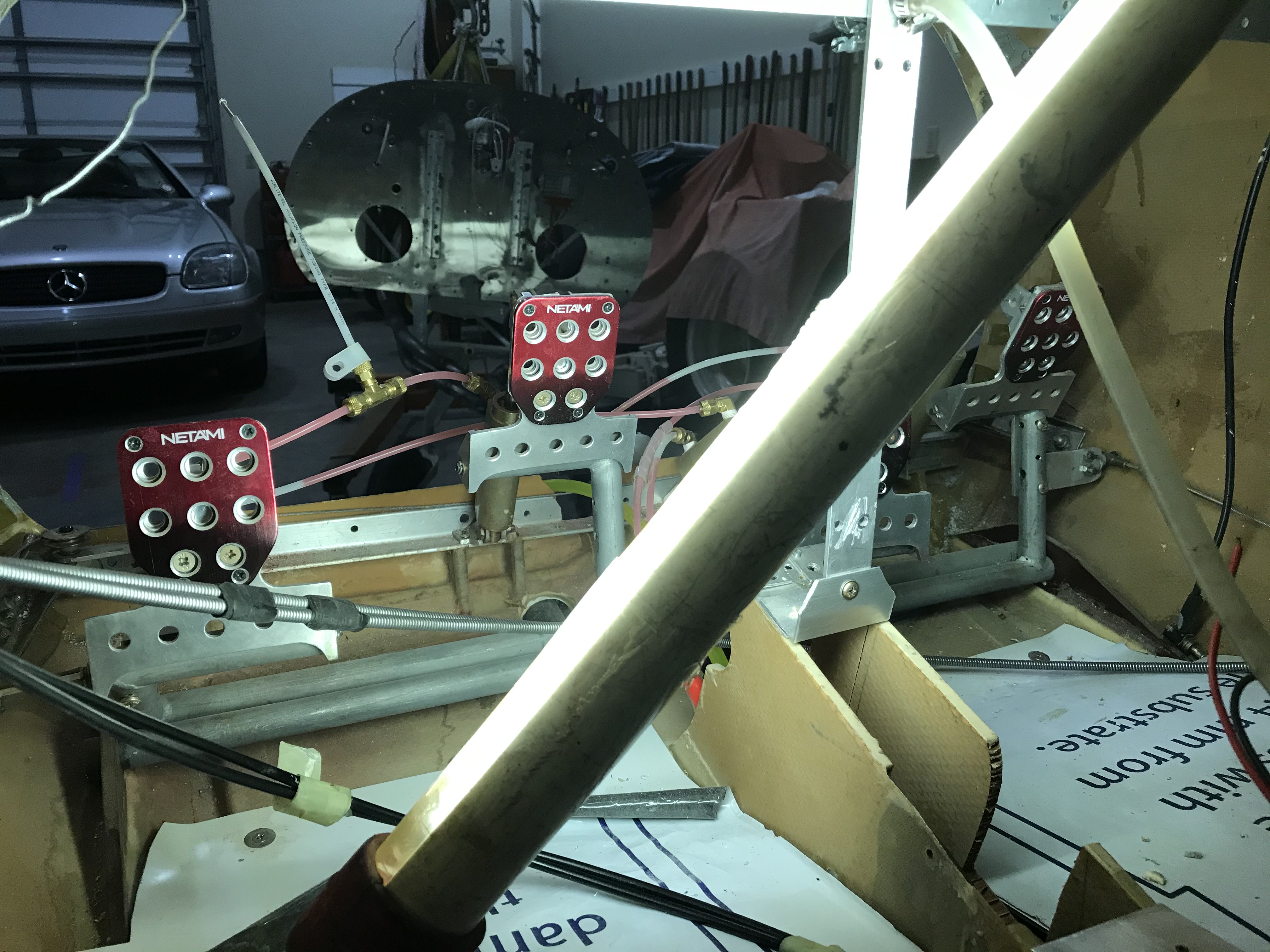

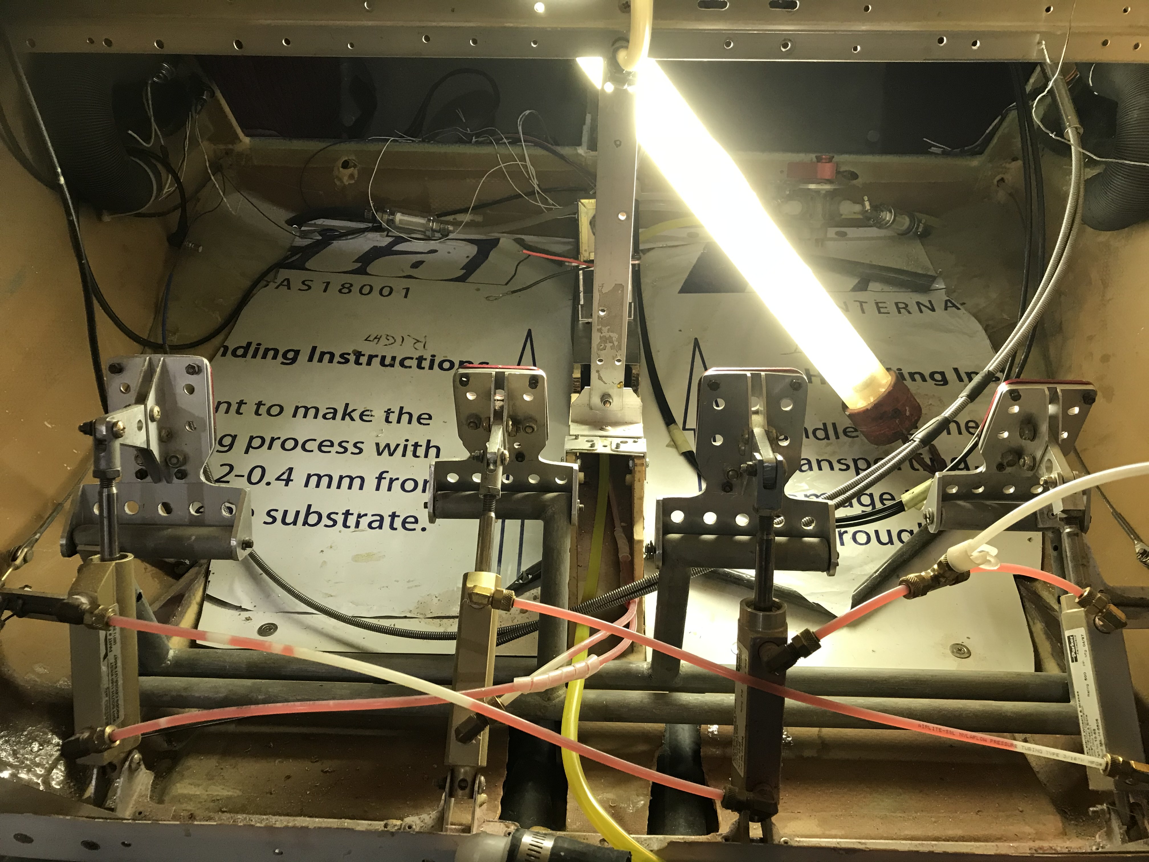

PostPosted: Fri Oct 09, 2020 1:40 pm    Post subject: Toe brakes and passenger brakes Reply with quote
Hi Greg.  I dug these up from the archives.  I also ditched the cherry juice for DOT 4, which can handle higher temps.
Be advised, there’s absolutely no coverage in any of the build manuals that I know of, for this modification.  Though it’s not particularly difficult for an experienced builder, I would advise anyone attempting this to get some help from tech counselors or similarly qualified personnel.
Best, Mike

Thanks Mike, appreciate the pictures. The new owner is a retired A&P so he will do well.
