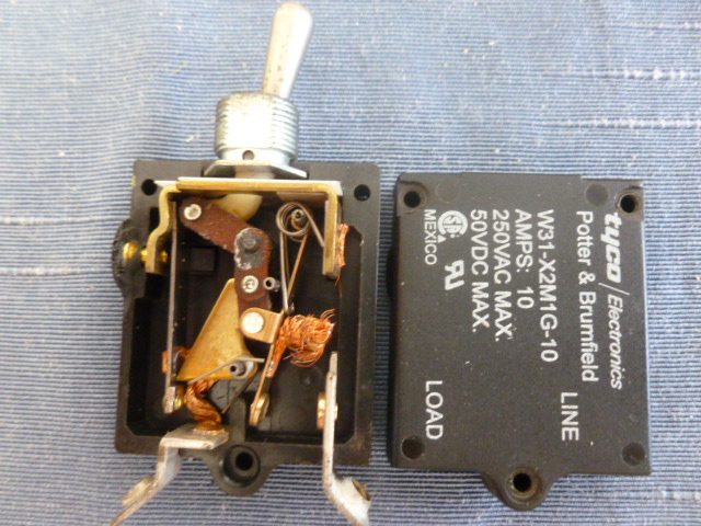

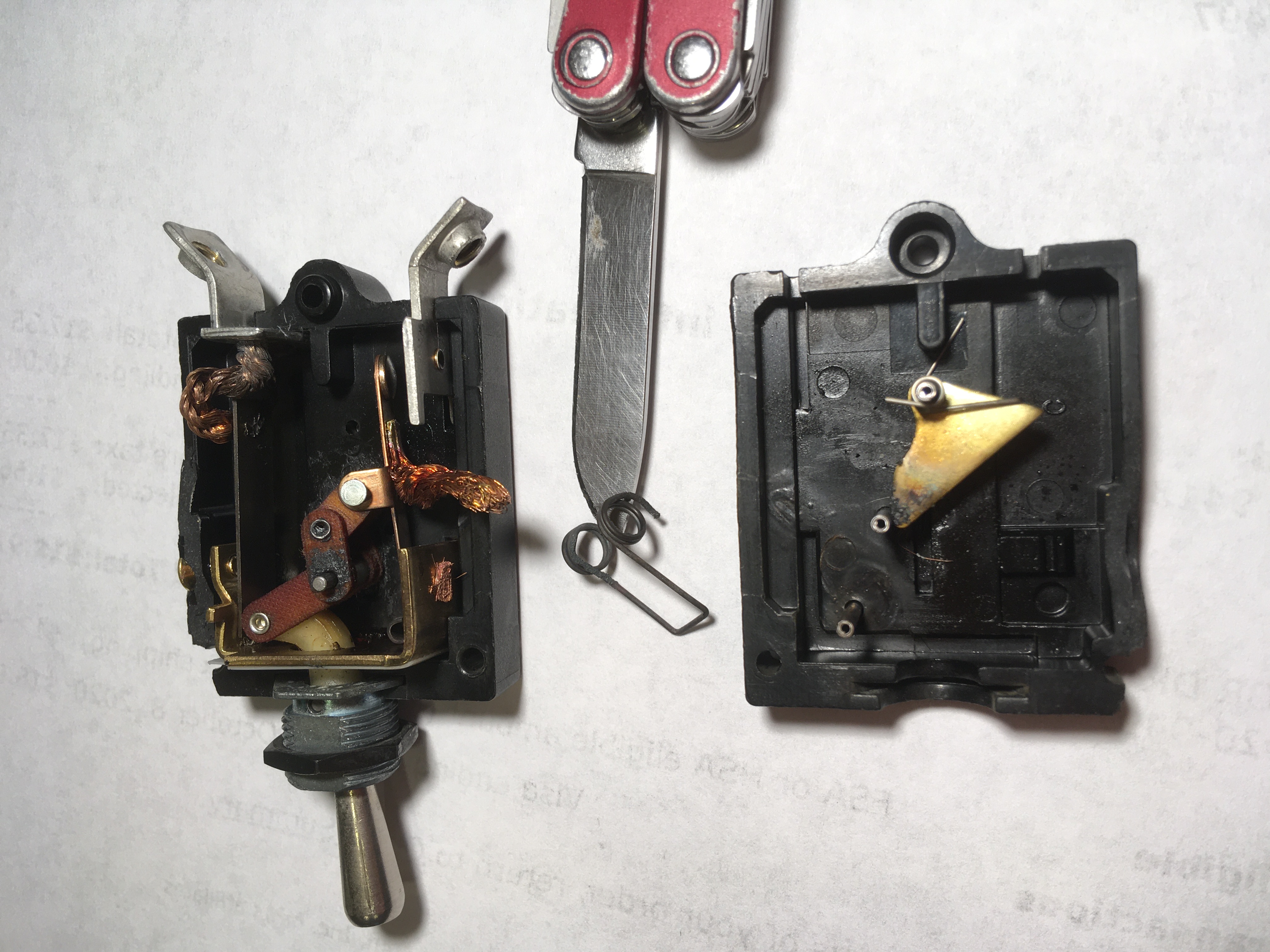

Here's a picture for now.  I broke in before I sent my initial message.  Charred remains to follow.
I'm almost certain that the braid broke when I opened it.
The little barbequed U spring is missing most of its legs.  I wonder if one broke off and shorted something to start the failure.
The switch had lost it's "snap" after it quit.

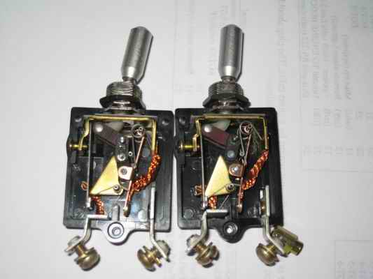

Here's a picture from a Beech website.  These are serviceable and very similar to what I have.

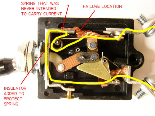

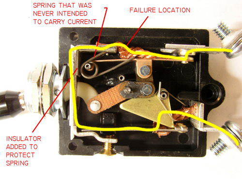

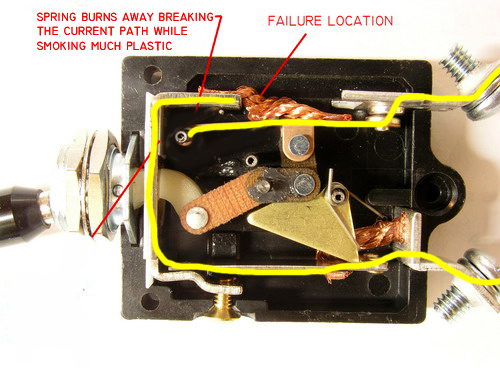

NO. The braid is the weak point.
Where it's spot welded to the contact it's hardened. As the switch is turned on/off the braid flexes. Same as what happens when you have a soldered flexible wire that is not supported at a point where the wire is still flexible (after the solder penetration).
It's a glaring design failure. Easily fixed by two molded pins in the plastic housing that would provide support where braid is again flexible. Why they haven't done that after the extensive failure history is beyond me.
Do not use these switch/breakers for flight-critical items!

PostPosted: Mon Oct 12, 2020 8:04 am    Post subject: Breaker then pump failure Reply with quote
At 08:58 AM 10/12/2020, you wrote:
--> AeroElectric-List message posted by: Kelly McMullen <kellym(at)aviating.com>
That AD is rather controversial, in that the exact same breaker is used in many other plane models and brands, but the AD was only issued against specific Beech models.
Kelly
I was on the team that worked that issue at Beech.
The failure mode that started the investigation
involved switch-breakers subject to the highest of
ship's loads, i.e. electric prop de-ice. I know that
same s/b was used on some Cessna models . . . but
perhaps only on lightly loaded circuits.
Root cause is a mechanical issue. The fine strand
jumper wire starts to loose strands due to operational
flexing of the jumper.
In the incident switches, loss of that jumper caused
system current to flow through the spring. For the
smaller switches, 5-10A, there is no immediate
indication of failure. For the higher current
applications, the spring heats up causing
smoke from the burning of the switch's housing.
I read that the smoke rather jetted from around
the switch's actuator handle.
Here's my library of photos and illustrations
generated to support my task at Beech along
with documents speaking to field responses.
https://tinyurl.com/y48y93rk
I worked analysis of the carcasses while others
researched affected aircraft . . . which was
a whole lot! There was a potential for thousands
of aircraft and tens of thousands of switches to be
at risk.
Cessna had a similar situation as cited in documents
offered above.
This was a tough one. Existence of the insulator
did not stop mechanical failure of the braid . . .
it only prevents smoke generation by the heavily
loaded switches. With the insulator in place,
the switch simply opens up.
Replacing all the at-risk switches in all fielded
aircraft was a really BIG deal. The Bonanza Society
and AOPA did a survey of affected aircraft owners
and came to the conclusion that the failures
were rare, occurrences of spring failure and
smoke were rarer still. They opined that these
events were very low risk and that a more relaxed
approach to dealing with the condition was
warranted. The FAA agreed.
