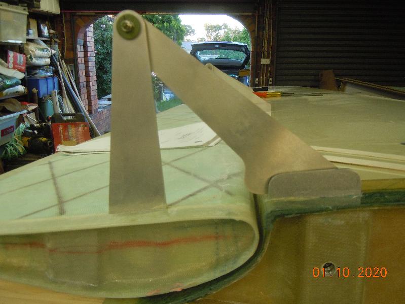

I am currently attaching the port flap to the wing on my trigear, I
find, for whatever reason, that the W20 bracket is too short by 12mm
when the flap is in its correct position. Rather than live with this
mismatch at the bolted joint, I will make up a new longer W20 bracket.
Does anyone know what grade and temper these aluminium brackets are made
from?

BrianIt looks to me as thought the lower surface of the flap is not aligned with the lower surface of the wing...or is it just how it looks in the photo?

William, I think its just the photo, I put a rule on the lower surface and checked the intersection, its hard to tell for sure but its very close to being laminar.

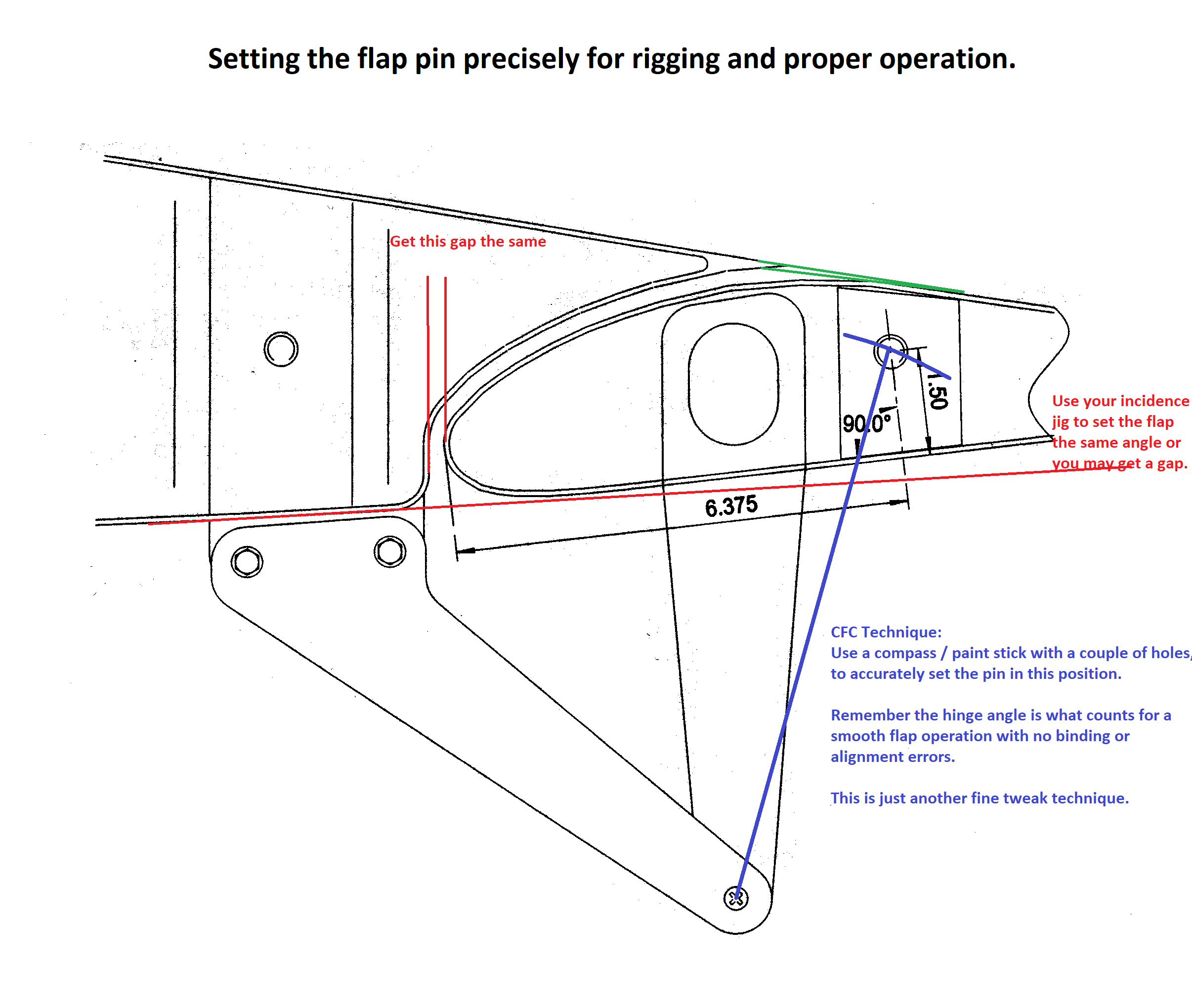

1. Be sure to make the flap fit on the left and right absolutely identical in gap between flap LE and closeout, dead level with the bottom of the wing. Make the line through the inboard and outboard flap eyes even and at the right point using the template. Middle flap bracket is set with string. IF THE FLAP W19 OR 20 IS TOO SHORT: Lay out your template and assure the wing flap is positioned per the manual using the incidence board and dead level with the bottom of the wing then clamp your W19/20 brackets. If too short, simply draw out a new one out of carboard for the outer shape and make another out of 1/8 6061-T6 After fab is complete, clamp in place and check operation. If off laterally due to a FL1 or 2 misalignment , you may either bend the W19/20 or use a spacer to displace the bracket to allow smooth operation.
2. I don't set my flap pins exactly like the manual. I use a compass (actually a 3/4 inch thick stick and pin/pen). Each flap drive pin needs to be set the same. I find that the swing of the flap tube and hinges is slightly off as indicated in the manual and by using a large "compass" I can set each flap pin so it is exactly in line with the hinges. It is not a big deal, but for those of you always having to lift or pull down on a flap to get the flap engaged with the wing pins in alignment, that is your problem or at least part of it.
I've attached a picture for my shop technique on the compass concept.
Best Regards,
Bud Yerly
