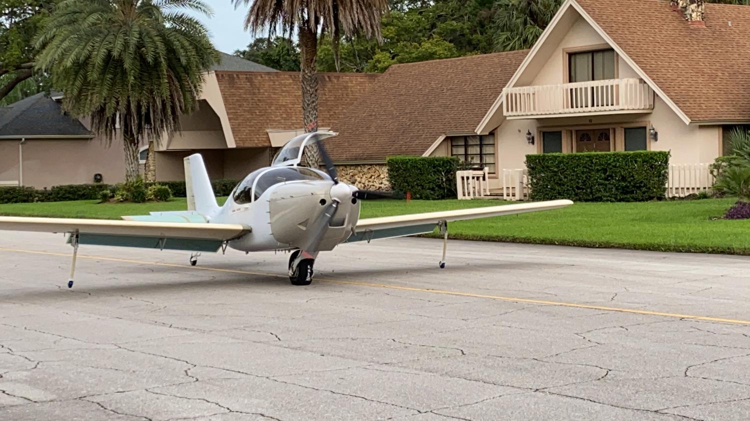

Oh, just wanted to post a picture of my Europa doing taxi test last weekend. Very exciting moment to be able to finally put all the parts together, see it as complete airplane and take it around the neighborhood for a spin. As you can see a lot of things are still being held by Clecoes.
Still lots to do to complete (pretty much all control surfaces and wings need filling and lots of little things here and there but it is a complete machine right now.
Special thanks go out to the this group, the Europa Club and in particular Bud Yerly for all the help and support during this arduous process. I'll post something when the airplane finally flies which I expect around the beginning of next year.
Now all I need to do is find a way to put the wings on that doesn't take an hours (how in the world Europa claimed the setup would take less than 5 minutes dunno) Maybe with practice Very Happy
