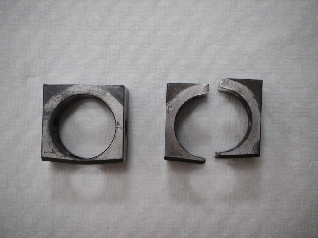

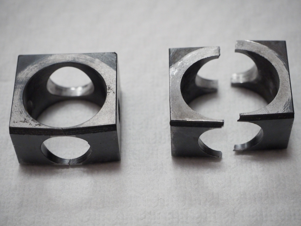

Anyway, after fixing the engine and while doing the annual together with
the previous owner/builder, it was discovered that the rear wing socket
housing, part W26B, starboard side, was cracked in two parts. Further
inspection showed that also the port side was cracked, albeit not having
split in two just yet. Please see attached photos.
I've got the spares from the manufacturer however, I'm curious if this
is a known problem? Any thoughts on what could be the cause? Anything
further to look out for?
My local mechanic seemed just as puzzled as I was when looking at how
thin this part is. I mean what is it, 2 mm?
One thing to consider: The aircraft was built as a monowheel but crashed
on takeoff during flight testing, making a hard landing and a ground
loop. The incident was traced to a construction error in the control
line attachment to the rudder, causing alterations in the design (some
of might be familiar with this). The aircraft was then repaired (by some
sailplane workshop that seemed to know what they were doing, I've seen
the photos at least). Among other things it got a new tail, a CS prop
and was rebuilt as a trigear. Might this new discovery simply be residue
of that old incident?
Also, the builder's manual states that the W26B and C parts should be
loctited together. However, there was no trace of this. I'm not sure if
that instruction has been there since the beginning or if it could be a
later revision? However, I sort of have my doubts as to some loctite
being able to strenghten this construction enough to not break from
whatever broke this...?
Finally, any thoughts on how to reassemble these parts? Where does the
Loctite go? Just on the barrel and make sure the holes align before i
dries? How to you avoid getting loctite on the surfaces between the
barrel and the socket body (W26A)?

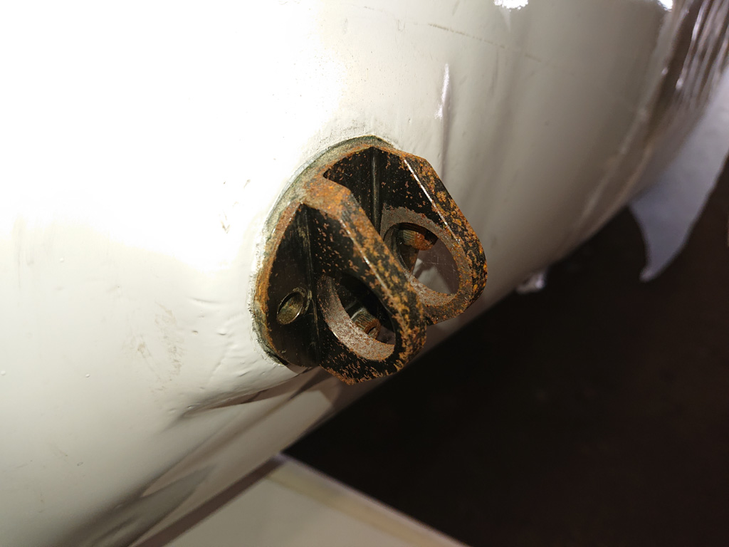

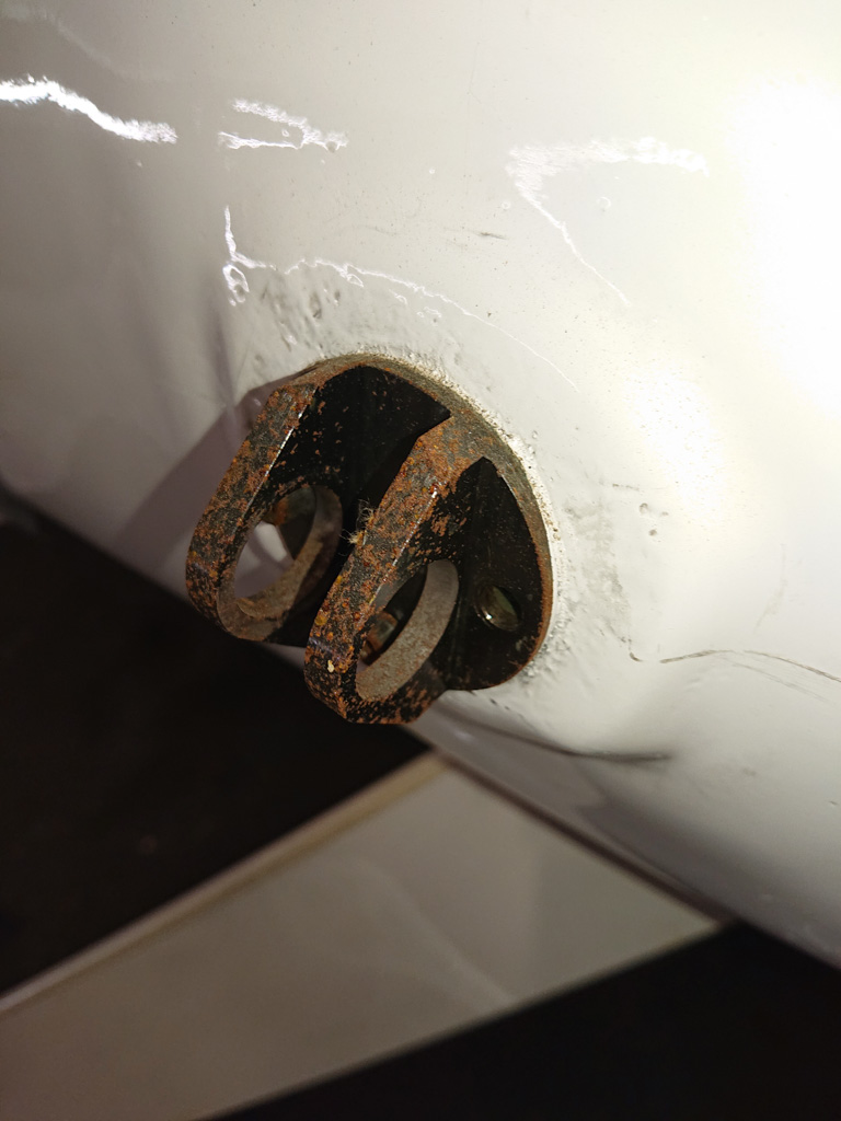

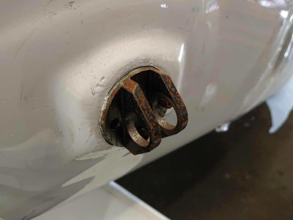

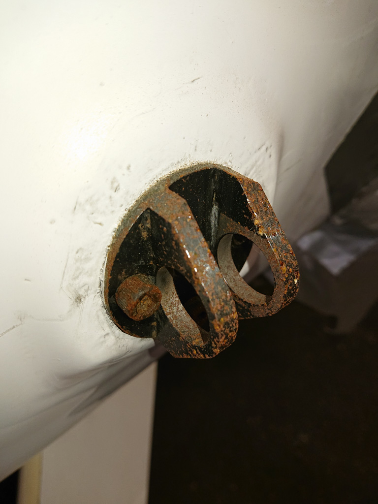

Now, on inspection, the W26A socket bodies show signs of corrosion.
Please see the other attached photos. Anyone have an opinion on just how
bad this is? Do they also need changing? And does that require
composite-work? I've been looking through the builder's manual but I'm
afraid I'm not quite up to understanding all of it.

The failure of the socket indicates the crash may have been more severe than anticipated.
In all my years, I’ve seen corrosion on older socket parts that were not as well protected as the new bits are. I have never seen a failure in the 26A as this was a well engineered and tested part by Europa. If installed backwards, this can happen.

Loctite is between the barrel and that thin rectangular piece you call it so they operate as a unit. The wing pin goes into the fully assembled socket and allows it to move up and down just a bit. If not Loctited the barrel can rotate and make pin insertion more difficult. (Frankly, during wing install, simply note the orientation of the barrel is all that is needed.) Note that the assembly thin side goes on the fuselage side. Don’t get that backwards as it builds up stress and may be a part of the failure you see

The wear mark on the inside vertical surface of W26 just above the central bolt indicate that at some point W26A was leaning heavily on W26 in a 'negative g' direction of loading, which may explain how it then broke i.e. the weight of the wing transmitted in bending through the lift pin caused W26A to lever against W26.
That wouldn't occur during a normal flight maneuver and when properly rigged. Perhaps the downward leverage occurred during derigging after removing the spar pins, and assuming the spar cups were misplaced.
I'd check the lift pins for bending too and that these are not angled (or bent) above the centreline of the inboard spar projections (and/or that W26 has been set vertically).
Duncan Mcf.

As far as the structural strength, the yoke piece 26A and the barrel 26C carry the load of the wing pulling forward under max G load. This barrel is designed to move up and down.

David Stanbridge reached out to me in response to my post here and I've E-mailed them the pictures as well. Their recommendation was to remove the rust and oil it to prevent further corrosion.
Now, my local mechanic and I decided to have me paint the W26A using "hammer paint" after sanding. Here's to hoping that the parts will still fit. It shouldn't rust anymore anyway...
The way I recall it, the W26B was correctly oriented when we found the totally broken one. However, it had almost fallen off so I can't be sure. The port side one however, which I later discovered to be cracked as well, was correctly oriented. That is if I remember correctly. I might again here just be assuming it was installed correctly due to having read the builder's manual afterwards.
