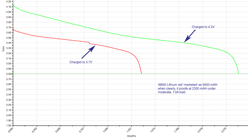

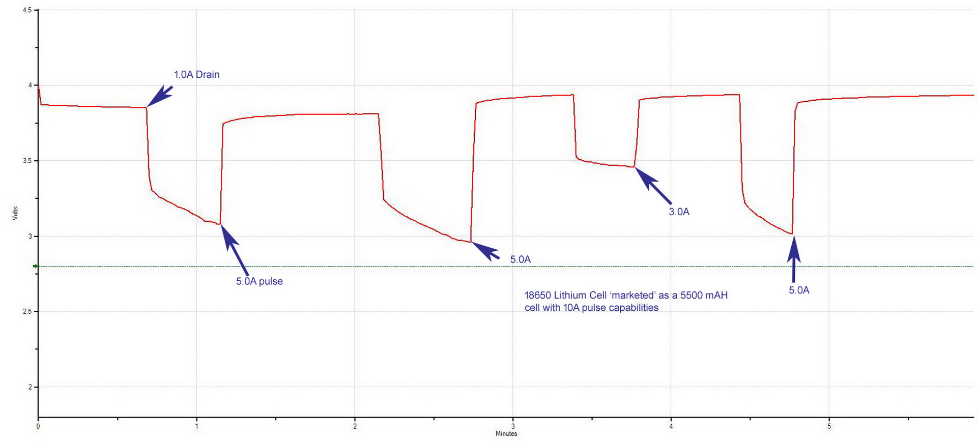

Attached are data plots on some 18650 cells
marketed as '5500 mAH' devices with '10A
pulse capability'.

Based on some 'marketing' assertions I purchased
some cells for consideration. The cells clearly
tested at MUCH less capacity and sagged by 25%
voltage under just a 5 Amps load. Clearly
incapable of practical service at 10A.
Note the difference in stored energy for having
been charged to 3.7 versus 4.2 Volts. If you
charged these cells in a charger optimized
for LiFePO4, you would achieve about 1/2 the
chemical capacity of the cell.

 Filesize:  141.53 KB
 Viewed:  10133 Time(s)
 Filesize:  154.99 KB
   Sorry Ron, the short answer is, "Lacking
   engineering performance data on the proposed
   device, you're searching around in a coal
   mine for a black cat with no flashlight."
   I'm not implying that ALL marketing hype is
   suspect . . . I've purchased many products that met
   their nameplate performance ratings quite
   well. But lacking hard data from the manufacturer
   or your own measurements, then it's a bit of
   a crap shoot.
   If you have exemplar cells you're considering
   for the task, mail them to me and I'll suck
   out their precious bodily fluids to MEASURE
   from what stuff they are made.
