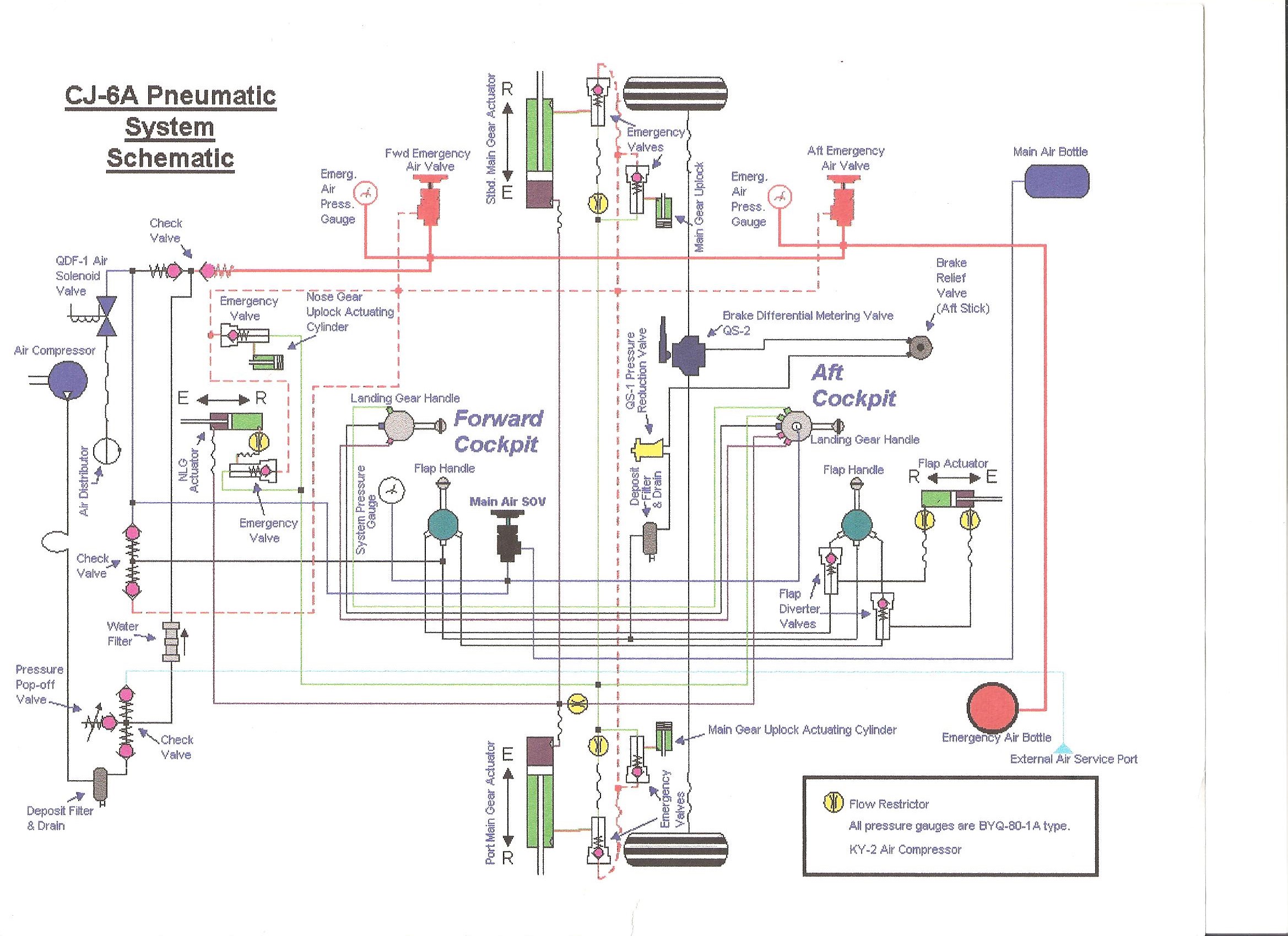

Can someone send me a CJ6 pneumatic schematic?

PostPosted: Tue Sep 01, 2020 11:22 am    Post subject: Air Reply with quote
Bill
Go to Doug Sapps web site.  CJ6.com
He has a color coded air schematic there.
He also has the parts books etc.
If you have a CJ.  You need to know Doug.

<CJ pneumatic system.jpeg>
wamflight(at)gmail.com
PostPosted: Tue Sep 01, 2020 12:07 pm    Post subject: Air Reply with quote
Airplane sat for 7 months. Turn on air and immediately air is flowing out vent holes on side of rear gear valve and forward flap valve??? Never had an issue. Covid 19?
dsavarese0812(at)bellsout
PostPosted: Tue Sep 01, 2020 12:40 pm    Post subject: Air Reply with quote
The gear actuators may need overhaul because the air is leaking by the seals in the actuators, including the flap actuator. Look in your log books and see if you can determine how many years it has been since the actuators and diverter valves were overhauled. If it's more than 5-7 years, you should seriously consider either replacing them or overhauling them.
