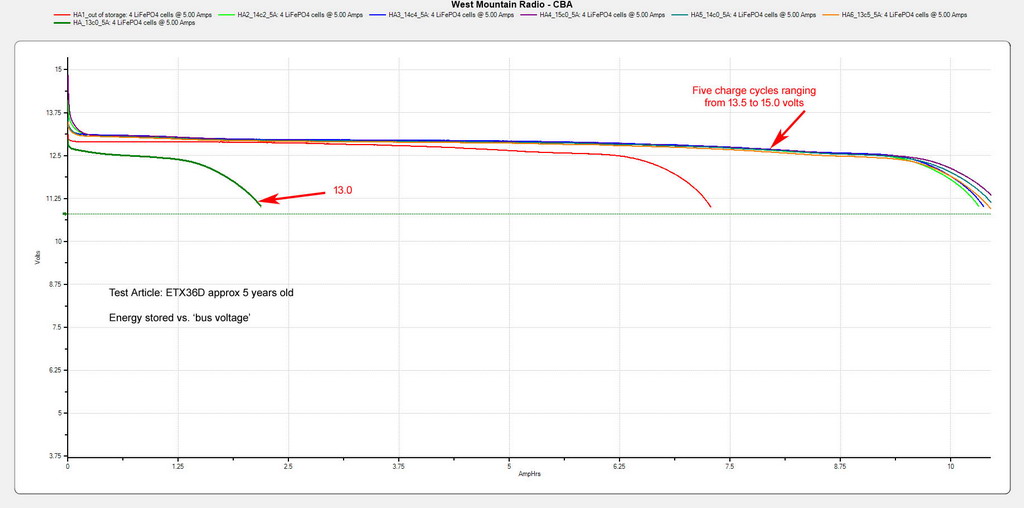

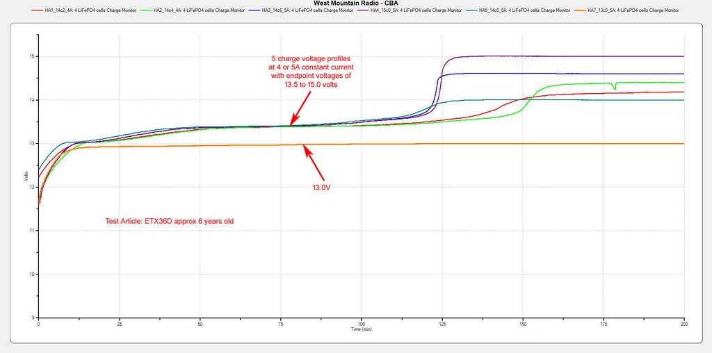

The two attached plots are interesting. The test article
is an EarthX ETX26D graciously donated to our 'cause' about
6 years ago. The plots illustrate battery behavior when
subjected to an array of charge/discharge profiles.
In the charge plots we see the battery response to
being charged in 0.5 volt steps over the range of 13.0
to 15.0 volts.
The 15.0 and 14.5 volt curves show a marked inflection
of charge current approx 2 hours after starting the
test. As the charge voltage is lowered, the inflections
(achievement of full charge) move outward in time and
are less pronounced. The interesting plot is at 13.0
volts . . no inflection . . . i.e. the battery doesn't
take on any charge.
The discharge plots are equally interesting. Note that
13.0v charge pumped no appreciable energy into the
battery chemistry. However, charging at 13.5 to 15.0
volts fully charges the battery. i.e. the battery
performance (except perhaps for charging time)
is unaffected by bus voltage. Note: the red plot
is what the battery delivered 'off the shelf' after
having been used/stored/maintained at intervals
over the past 5 or so years.
I not that the battery's demonstrated capacity is
on the order of 10.3 AH . . . down slightly from
demonstrated 11.6 AH when received as new.

A noteworthy fallout of my studies suggests there
is no value in running the bus at any higher
than 14.0 volts for the LiFePO4 products.
