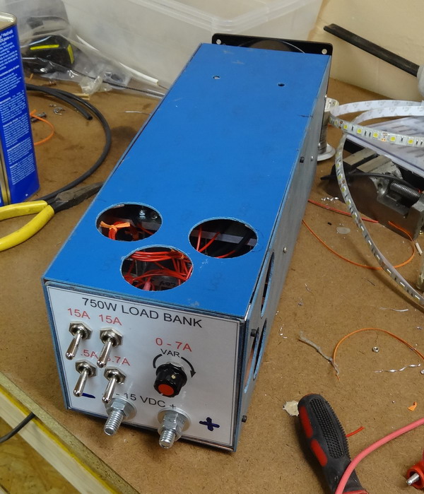

It's not possible to load an installed
alternator to design limits using ship's
accessories . . . we add current draw with an
adjustable load bank that lets us fully
challenge the alternator.
This is a load bank recently used to
validate a new STC on an alternator
installation.
This seems like an extreme measure given
that loading a qualified installation
to worst case for more than mere minutes
is practically impossible. But the test
proves that your properly functioning
alternator is meeting design goals.
