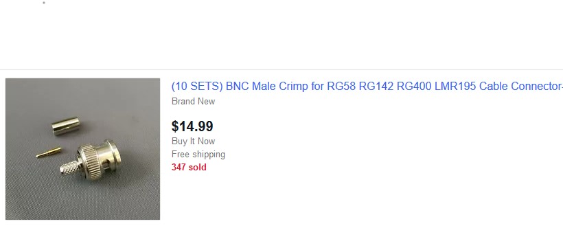

PostPosted: Sat Aug 08, 2020 4:59 pm    Post subject: RG400 with RG58 Reply with quote
At 06:46 PM 8/8/2020, you wrote:
--> AeroElectric-List message posted by: Chuck Birdsall <cbirdsall6(at)cox.net>
In short - that would work just fine.
The only caution I would add is that RG400 is slightly different in size
than RG58. Make sure the connectors you use are compatible with the cable.
Both are nominally 0.195" diameter and use
the same connectors. The shield grip sleeve
is a bit harder to push over the RG400 shields
because there are 2 of them . . . but it will
go.
