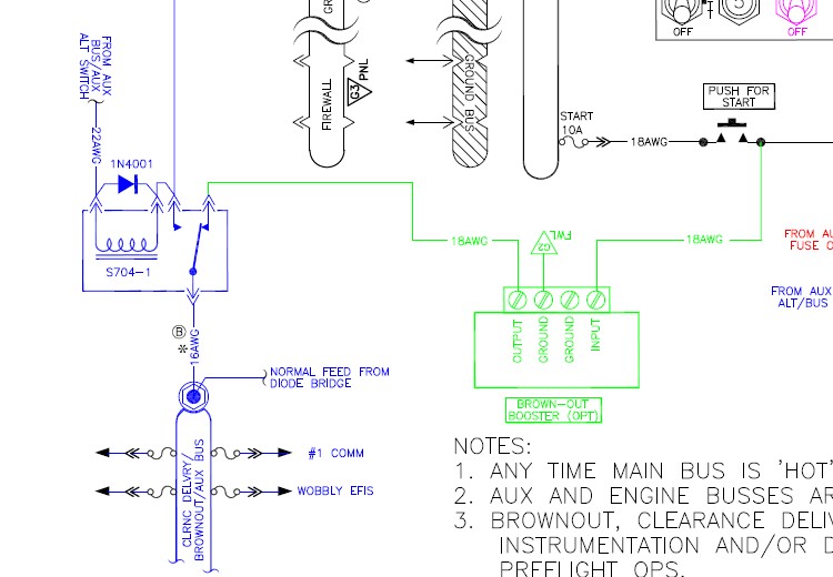

At 06:29 PM 4/1/2019, you wrote:
There needs to be a diode in the existing main power bus to prevent the DC-DC converter current from flowing to the starter.
Otherwise, that DC-DC converter will be unable to maintain 12 volts.
???? as shown in the z-drawings, brownout boosters are
switched to support ONLY the e-bus . . . just milliseconds
before the starter contactors close . . . and for as long
as the starter button is held closed. The "normal feed"
path includes the requisite diode.
Depending on load, the DC-DC converter with a 5 amp
rating might have trouble maintaining 12 volts, let
alone putting out 33 volts.

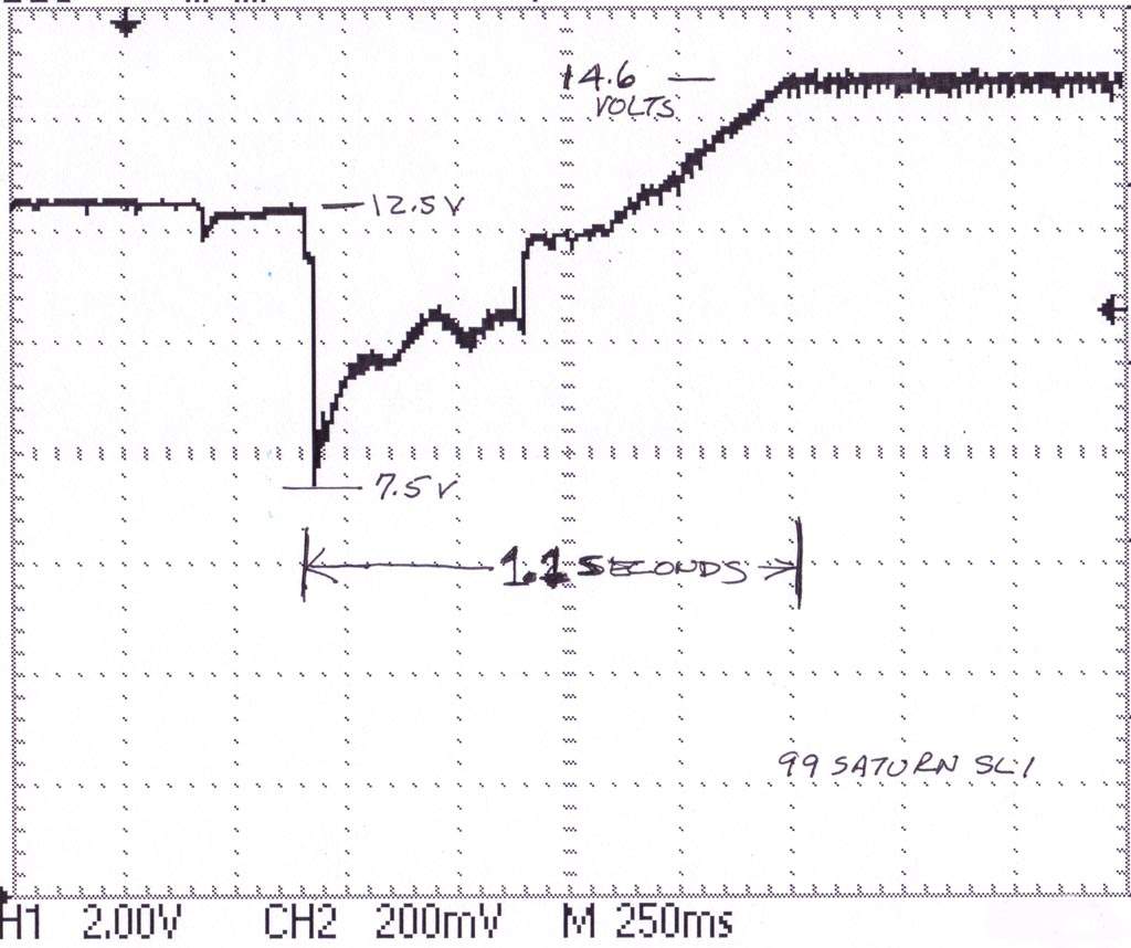

33 volts? No . . . only 14v. We're keeping the
e-bus supported at 14 volts for the cranking
interval that the battery is below 11 volts.
