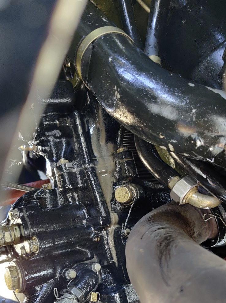

Noticed an oil leak on the right side of the carburetor after a flight yesterday. It was pretty hot outside and also did a few gyro maneuvers. The oil temp was at 72 briefly, then mostly 65.
Any ideas?
Thanks.

oil sucked into the supercharger and blown out through intake tube attachment nut ? or leaking compressor outlet fitting ?
