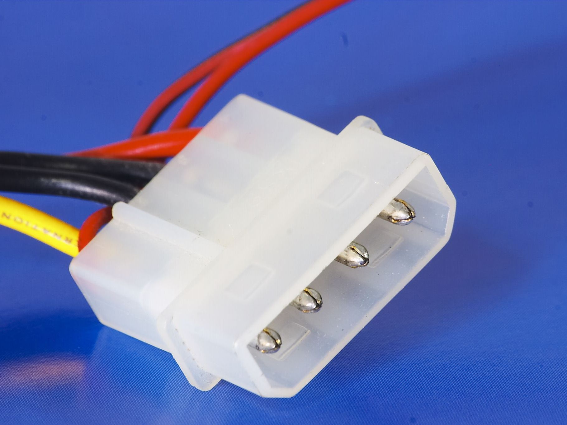

I've seen come 'conventions' but they tend to
be institutional . . .
In the dozens of 'design to specs' products
I've worked, I don't recall any specification
dictating gender of the pins EXCEPT where
the device was form, fit and function for
an existing device.
Virtually all customers had a preference for
the style of connector but the pin out gender
was left open. Most connectors are
relatively 'scoop proof' these days as
illustrated by this combination of pins
and housing . . .
