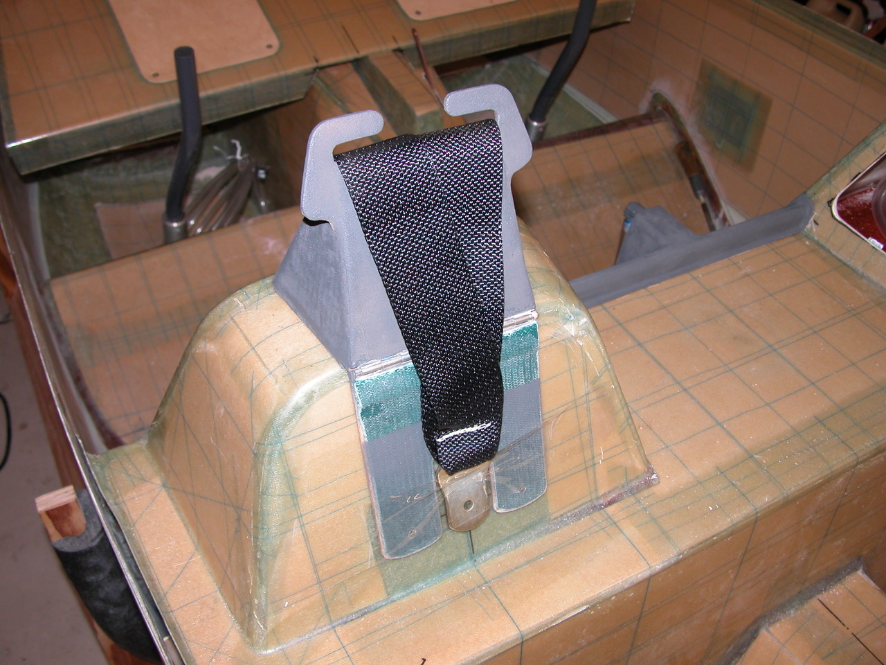

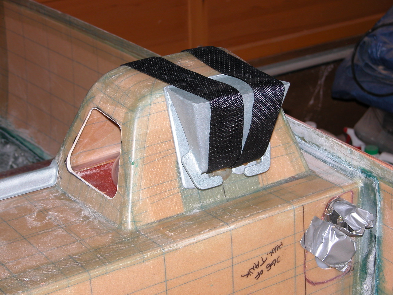

Will…yes…here are my sketches and a couple of pixs…assembly tested to 10 G’s…let me know if you would like more info…Best, Fred

didnt you design a headrest "extension" to raise the shoulder height of the harness? I can find the posts but not the the design/pics on the forum. If it was you would you mind sending me some pics and the design
