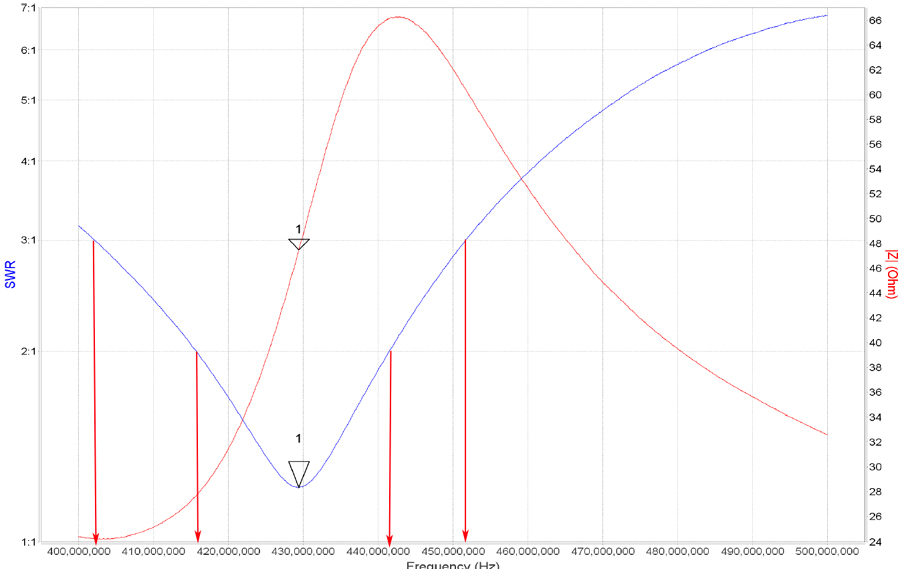

The attached plot illustrates an exemplar
antenna's performance over a range of frequencies.
The antenna's 'sweet spot' is at 429Mhz. The
antenna is satisfactory (2:1 or less) over a range
of about 416-442Mhz. Useful (3:1 or less) over
a range of 403-452Mhz.
Your SWR meter is a minimal utility vector network
analyzer. It just doesn't 'scan' or 'plot' for you
like a full featured VNA. However, with a little
data gathering and pencil work on a graph, you can
still get the information you need.

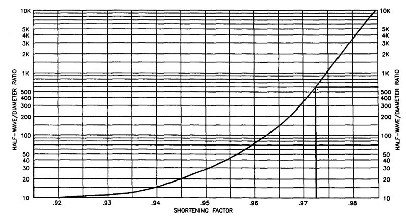

Figure 13-6 (attached) of the 'Connection speaks to
this phenomenon. The calculator linked above
takes this physics into account.
