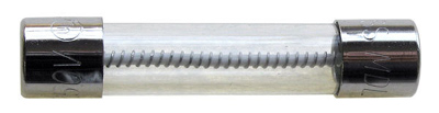

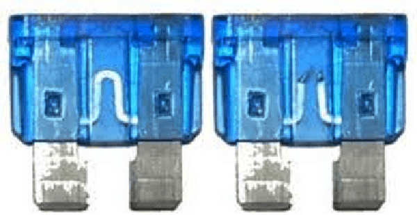

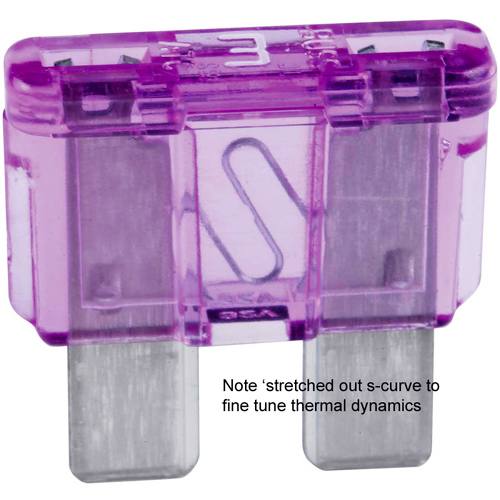

As a practical matter, the opening of an
electrically fusible segment tends to 'center up'
on the span. This is seen in the pictures of fuses
attached. As temperature begins to rise, heat
is generated all across the span and conducted
in both directions from any single point. The
CENTER of the span is least able to reject heat
to it's adjacent mass . . . it's getting warmed
up from both directions and also rising the fastest
due to effects of positive temperature coefficient.
Rising resistance increases electrical power dissipated
at that location more rapidly than anywhere else along
the span. Hence the temperature rise is regenerative
. . . the hotter it gets, the faster it warms up.

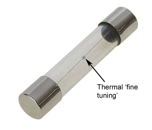

Here's a well written piece that explains the
thermal fiddling necessary to achieve predictable
i.e. fast versus slow blowing characteristic in fuses.
How about that little fly-spec of heat sink material
in the slow blo cartridge fuse?
https://tinyurl.com/ybkndmrc

Thanks for this, Bob. That such a little blob of solder can have such a big effect is fascinating.
Pat
Yeah . . . we don't know how 'big' big is but
intuitively we know that the effect is not
zero.
