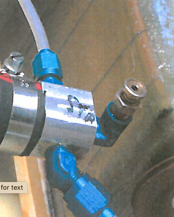

I hope to find two of these fuel tank outlet fittings originally produced for Graham Singleton in mod 10823.
Please message me direct if you can help.
Many thanks,
Roger

PostPosted: Wed Jun 17, 2020 7:43 am    Post subject: Re: Fuel Tank Fittings Reply with quote
Roger,
If you can't find them in the UK, I'm pretty certain I have them.
Jim
Roger - I turned up my own versions of these from aluminium bar stock - see:
http://www.rowlandcarson.org.uk/aviation/europa_435/making_tank_adaptors.php
and
http://www.rowlandcarson.org.uk/aviation/europa_435/tank_adaptors.php
and
http://www.rowlandcarson.org.uk/aviation/europa_435/tank_adaptor_c_fitted.php
Sorry, I don’t feel I want to spend the time on making them again just now, but if you are really stuck I might consider it!
Alternatively, if you know of or can find a model engineering society in your neighbourhood one of those guys might be happy to do the job for you. I attach my dimensioned drawings of the 3 slightly different adaptors I made. I didn’t bother to mill flats on them as I didn’t have a milling machine at that time and (although possible) it would have been a bit tedious doing the milling on the lathe.
Hope this is of some use.
in friendship
Rowland
