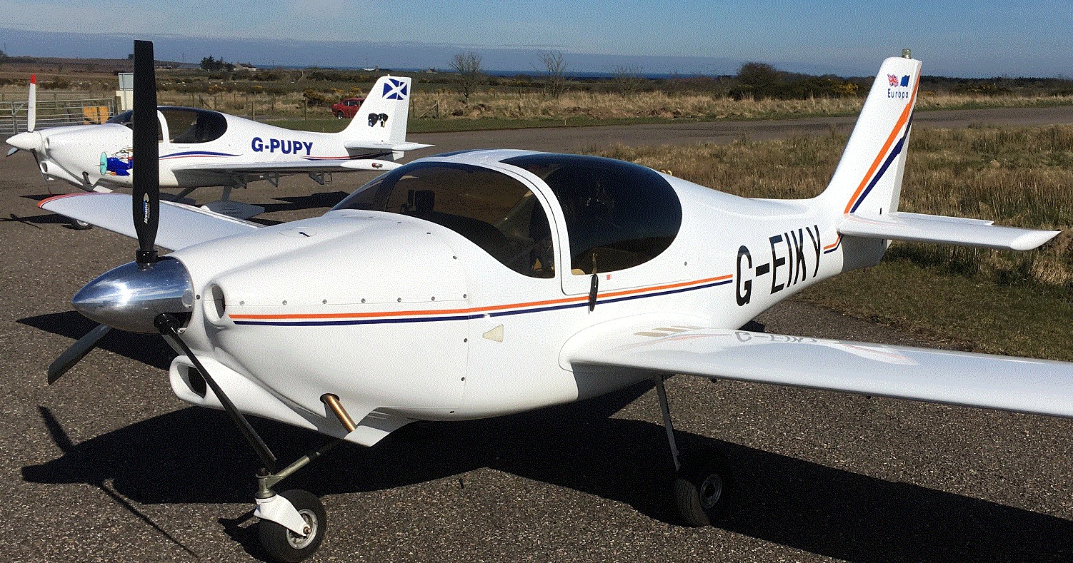

My aircraft which I built was a Classic Mono for over 900 hours and had a 912UL 80hp with Airmaster and 62" diameter tapered blades. After converting it to a tricycle and installing a 912ULS 100hp with 64" diameter wider blades, it has flown another 400+ hours during which time the firewall forward was altered to the Neville Eyre cowls, making it very much more like the XS f/w forward. (See attached image.)
I never actually measured the propeller ground clearance with the fuselage horizontal while it was still a Mono with 62" propeller, but subjectively I guess it would be much the same clearance as an XS tricycle with 64" propeller.
While it was still a Classic Mono, Airmaster made spinner bulkheads for me which very well matched the Classic cowls. No doubt they still have the molds. When I converted to Nev Eyre's cowls, I acquired a smaller diameter spinner which matches the XS cowls and gave away my big spinner with bulkheads to someone who needed them.
I don't believe that it would be necessary to lower the XS tail wheel spring, because reduced propeller ground clearance with a 64" propeller becomes more significant when the tail gets raised during take off. Yet I flew happily enough like that for many hours before concerting to tricycle u/c. The thrust lines for the XS and the Classic are the same.
