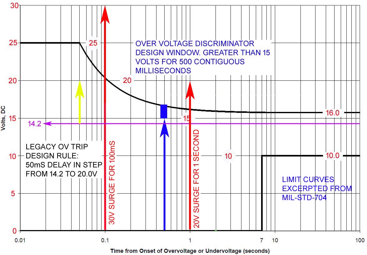

When it comes to ov definition, detection
and response, the attached figures speak
to 70+ years of design philosophy in
aviation electrical systems. 14V devices
are TESTED to withstand 20V perturbations
for 1S and 30 (or 40) Volt perturbations
for 100mS.
Every device bolted to an airplane is
expected to shrug off bus voltage
perturbations between the high and
low voltage plots for intervals of
time laid out on the x-axis. When
tasked with my first ov relay design
about 1975, the rule of thumb was to
design for a 50mS response to a step
increase in bus voltage from 14.2
to 20 volts.
While the electronics were solid-state,
the 'timers' were pretty crude by contemporary
standards. Today, micro-controllers
allow us to start a timer when the
voltage exceeds some lower discriminator,
say 15 volts. If the voltage stays above
that value for 500 milliseconds, we
trip the ov protection system. If the
voltage falls below 15v before
time-out, the timer resets and the process
starts over.
This all but eliminates nuisance tripping
of an ov protection system while offering
robust but timely management of a recalcitrant
regulator/alternator.
