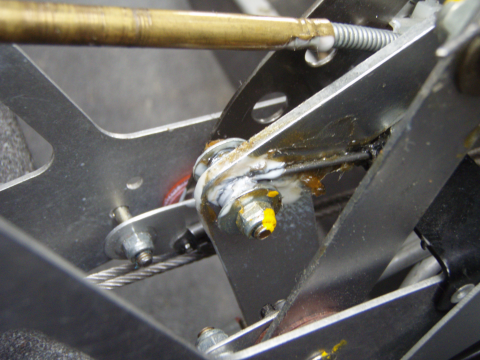

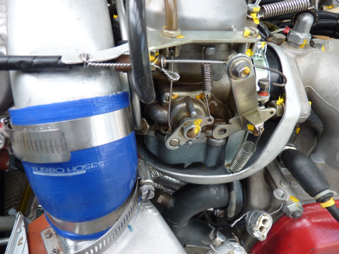

Some pictures of *our* setup
[img]cid:part1.6BD3C5DD.5C8F0767(at)free.fr[/img][img]cid:part2.D3A135A3.7A04F837(at)free.fr[/img]
Being the one who installed the cables and routing, I ensured gracious sweeps and easy swiveling at the lever junctions.
We never had any issue with the throttle cables in  15+ years, some degree of smooth friction make them "feel" like any type certificate aircraft.
And BTW, we never disconnected the piano wires from the lever arms and provided ferm stops on the throttle lever, so never had to re-synch the carbs.
http://contrails.free.fr/engine_rotax_stops.php

Hello Jerry,
Do you stutter mate?  Just joking . . . . . your post came through seven
times on the list!
Since only one cable was frayed, I suspect the TH03 fitting was binding
on the sleeve on which it should pivot freely.  This would cause the
fitting to flex the cable at the end of the crimp as it appears it has
done.  I further imagine that in cold countries like yours that after a
winter lay-up, any grease on the fitting could become quite sticky and
may well be the culprit.
Best regards
Kingsley
