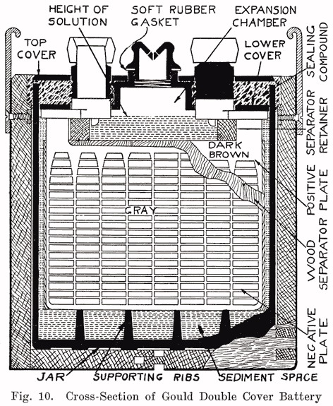

'Shorting' requires motion . . . in the heyday
of flooded batteries, active material 'pasted'
into the cell grids was subject to degradation
with age/abuse. Chunks would fall out of the
plate and migrate into the wet space between
plates. Most of the stuff would fall to a
'sediment space' under the array of plates.
Plates were EXPECTED to shed chunks of expended
material so there was a 'basement' for storing
the dead stuff.
But a battery left in service past its prime
was subject to so much flaking of active
material that adjacent plates could become
electrically connected . . . i.e. 'shorted
cell'

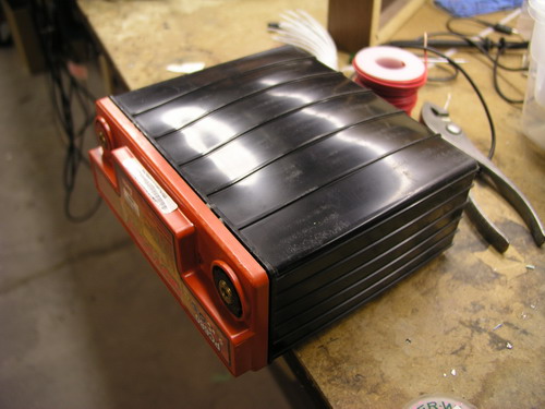

An RG battery is a different breed of cat
all together. Separators between cells
is a pretty tough but thin, porous
plastic or fiber. The plates are compacted
with significant force before being
inserted into the battery case.
For 'motion' to occur in these devices,
requires severe degradation of the
cell's active materials. This happens
when the battery has been allowed to
self-destruct with age or when subjected
to sustained over charging. Then you
get swelling of the active material
and risk of separator compromise.
But even in extreme cases of AGM
battery abuse, shorted cells are not
a given. I've seen some pretty badly
'puffed up' AGM batteries that were essentially
destroyed but had presented no shorted
cells.
A battery removed from service in an aircraft
at the appointed time in its life cycle is not
going to exhibit effects of severe ageing or
abuse.
